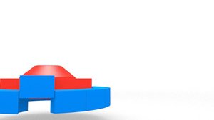

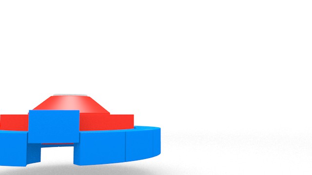

Blender Rendered Start Frame Blender Rendered End Frame The key frame moves the camera for the wheel to go from right to left on the screen. The block on the middle is going up through key frames. The Top grey ball is the parent to all blue and red objects. This object is rotated at 625 degrees.

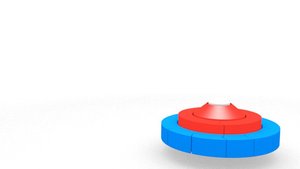

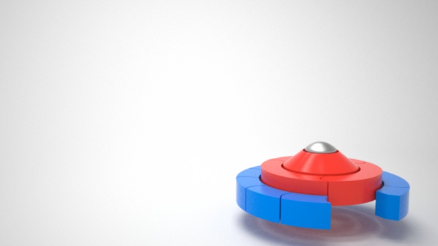

Indigo Rendered Start Frame Indigo Rendered End Frame As you can see the middle object is gone on the first picture. On the last picture the blue block is somewhere on the right as if it was rotated on the Z axis! The object does not rotate properly in relation to it's parent. Now if you take the parent object (grey ball) and rotate it to zero, everything is fine and the blue block goes back to it's proper place and goes up and down properly.
Also, when the parent is rotated at 625 degrees, if I remove all keyframes on the child object, the child goes back to it's proper place.

re: the first bug, (the child hierarchical transform problem), you can work around it easily by turning off motion blur in the Indigo engine settings in blender.

Regarding Blender 2.64, I've been running it with blender 2.64 and 2.64a without problem...
As for Motion Blur deactivated, indeed, it is working fine without it. Looking forward to having it available soon
