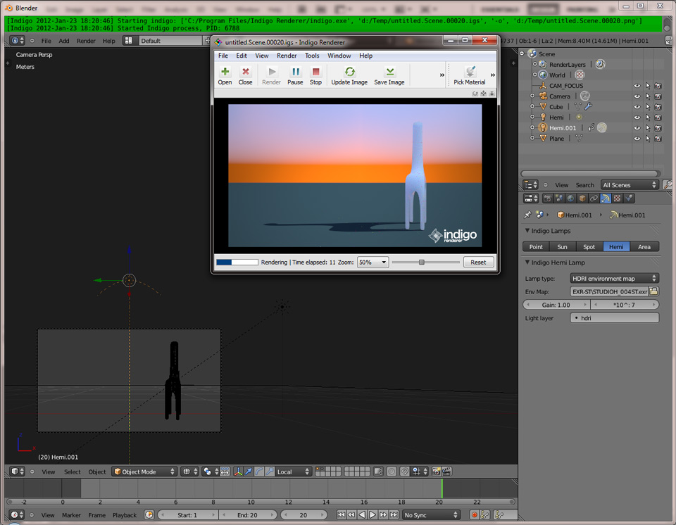

It's already in the latest version. Just use a sun and hemi lamp at the same time.

Post by Doug Armand » Thu Feb 16, 2012 6:40 pm
Wow so it is!. Took me a while to work it out but seems to be working fine - many thanks for that Dougal :D
