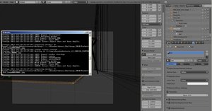

Alain wrote:Blendigo seems not to work for me as well.
Blender 2.58.1
Indigo RT 3.0.14 64 Bit
Win 7 64 Bit
What do I do wrong ?
Kind regards
Alain
This looks like something in your scene has a blank name? It might be a material, texture, object, mesh - it's not possible to tell from the console view. It might also be an un-assigned texture or something like that. Double check your mesh+materials setup - if the problem persists, try to trim down the scene to just the minimum that causes the error and post it here so that I can analyse it.
Re: Blendigo (for Blender 2.58) 3.0.10.1
Post by Headroom » Thu Jul 28, 2011 10:14 am
I'd suspect a texture.
All other things (Objects, Meshes, Materials) have a name assigned by default.
However, assume you have created a material and texture (type : image) channel for that material. In the Indigo specific material panel you need to specify the texture to be used for a Indigo material slot, e,g, Material Color or Bump etc.
Then you decide to rename the texture. You have to reassign the texture to the Indigo material slot.
If you went directly from renaming the texture to the render panel you'll get exactly that error.
Then you decide to reassign the texture and try to render the thing again and you'll get the same error because you choose an Image texture but forgot to actually load an image :wink:

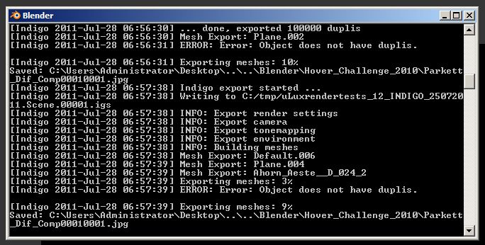

Post by Alain » Thu Jul 28, 2011 5:01 pm
Thanks, I guess I cleaned the texture part now.
But there is another error, see attachment:
What means "Object does not have duplis" ?
Kind regards
Alain

Post by Alain » Fri Jul 29, 2011 8:25 am
Yes I did, I installed the "normal" version of Indigo now and it starts now.
But I still have some questions:
-Is there no material and no texture - preview in Blendigo ? Or do I have to set materials like blind cow ? :-)
-What does the error message "object has no duplis" exactly mean ? I have 2 particle systems in my scene (objects distributed over a plane), could that be the reason ?
I still have that error:
Can somebody help me please ? I'm very confused that not even such basics do work...
Kind regards
Alain

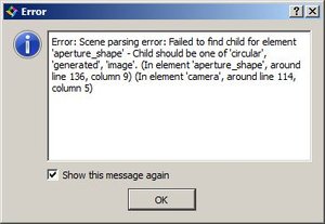

Post by Alain » Fri Jul 29, 2011 8:56 am
another one...
... what is wrong ?
Edit:
It happens when I activate Aperture Diffraction. Could it be a bug ?
Kind regards
Alain
Win 7 64 Bit, 8 GB RAM, Geforce GTX 480, Blender 2.62, Indigo RT Trial, Blendigo 3.2.12.0

Post by dougal2 » Fri Jul 29, 2011 10:56 am
Hi Alain,
Both those errors could be Blendigo bugs - I'll add them to the list of things to check & fix.
