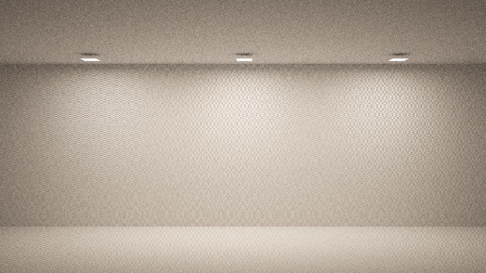

I suspected something was wrong:
IES lights are broken. The light on the left is a normal area light. The middle and right light both have 2 different IES files attached, but they clearly don't work...

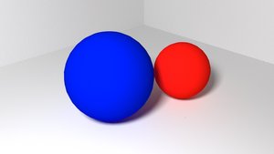

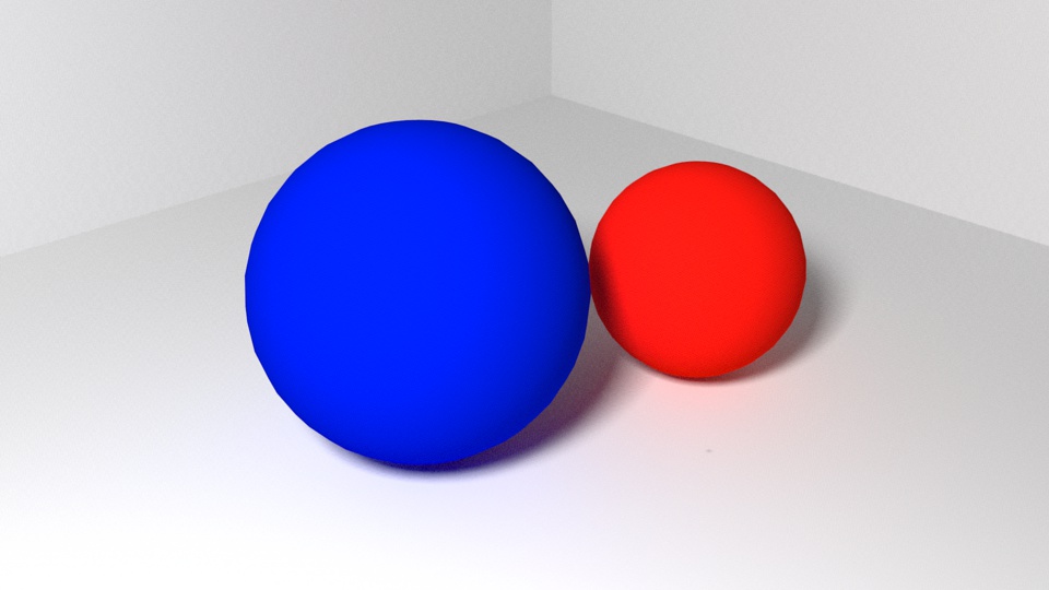

Now that I looked at the .igs-files, it sure does look like the exponent value is exported correctly. But still Indigo renders materials as diffuse.
Here's the .pigs -file and rendered image of my test scene:
phongtest.pigs
(19.93 KiB) Downloaded 277 times

That's because your IOR == 1.0. Try increasing that value and you will start to see the specular highlights.
