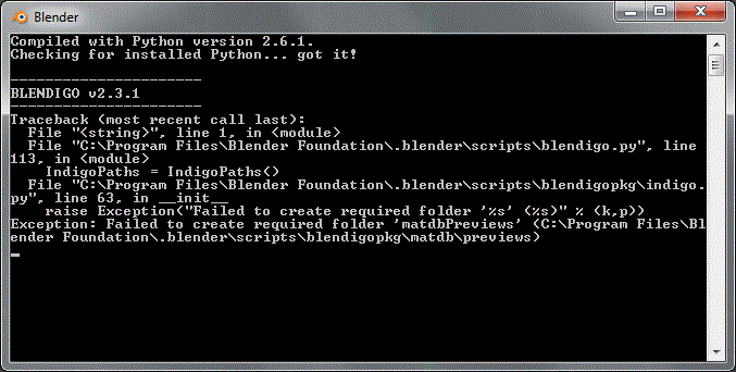

Ok, I installed the new script for access to particle support, and whenever I open Blender I get the same error message that Doug was getting..
Error%Broken installation of Blendigo, please reinstall
Abort
I've tried uninstalling and reinstalling, no luck.
When I go into scripts>render>render with Indigo, the same error..
when I make a new scene... same error.
This is the console:
dougal2
Posts: 2532
Location: South London
Re: Blendigo 2.3.x test releases
Post by dougal2 » Thu Feb 11, 2010 5:39 am
dammit, bitten by Vista's UAC again. I'll see if I can change the installer to write files to your home folder instead.
