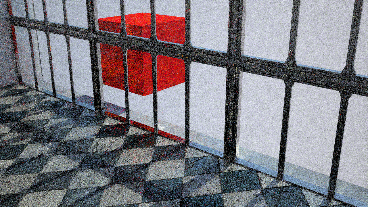

Post by Borgleader » Sun Jun 29, 2008 12:22 am
Alright. So for now SSS cube is removed from scene. I didn't do much since I spent most of my time trying to find what went wrong, but I added a little metallic border at the bottom to hide the seam between the tiles and the outdoor building, and I fixed the tile size (I might make them a tad smaller still but that remains to be seen).
Fixed tiles + Border

Post by zsouthboy » Sun Jun 29, 2008 12:32 am
oh, I know exactly what happened: your SSS cube and your glass had the exact same precedence setting.
Put the cube back in with a precedence of 1 and try again :)

Post by Borgleader » Sun Jun 29, 2008 4:06 am
zsouthboy wrote:oh, I know exactly what happened: your SSS cube and your glass had the exact same precedence setting.
@zsouthboy: Thanks it worked great.
