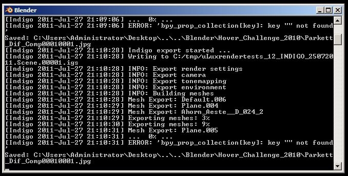

Re: Blendigo (for Blender 2.58) 3.0.10.1
Blendigo seems not to work for me as well.
Blender 2.58.1
Indigo RT 3.0.14 64 Bit
Win 7 64 Bit
What do I do wrong ?
Kind regards
Alain
Blender 2.58.1
Win 7 64 Bit
Kind regards
Alain
