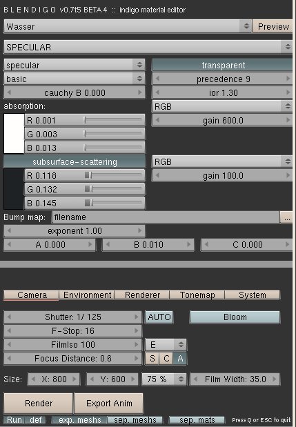

Can someone help me with the settings for milk in Blendigo v0.7t5_beta4?
I get colored liquids, but when I set the absorption to almost white the liquid gets transparent (with sss) :(
Post by Kram1032 » Thu Mar 22, 2007 5:48 am
you should set higher SSS, in this case ;)
absorbtion doesn't need to get whiter and whiter! It's a value, that tells you, in how many meters, the colour completely get's absorbet, so the values should be pretty high, n milk, I guess....
Also, blue gets absorbed fastest, as milk looks a tiny bit yellow...
Maybe, you should post an image and your current material :D
Post by Kram1032 » Thu Mar 22, 2007 5:54 am
Ok, I searched a bit... These are render settings, used by mentalray... don't know, if the values do exactly the same as in indigo, but you can try :D
IOR = 1.3
absorption = 0.014 0.025 0.142
SSS = 7 12.2 19
(for these SSS values, you have to set this:
R 0.07 G 0.122 B 0.19 Gain 100 Try it ;))
Macrob
Posts: 289
Post by Macrob » Thu Mar 22, 2007 6:29 am
no milk today :cry:

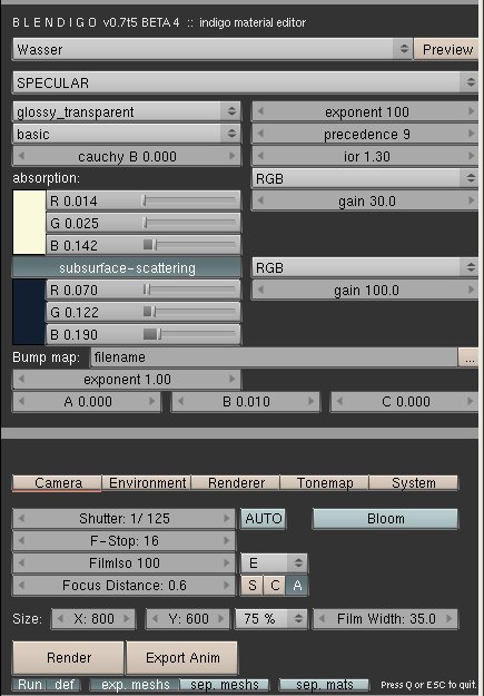

Post by Kram1032 » Thu Mar 22, 2007 7:27 am
hmmm... SSS seems to be wrong.
Press once onn the preview and get your Cursor away, then the colour should be inversed ;) Absorbtion looks good.
I'd say, you should extremelyy increase the gain in both values.
absorb. gain 300
SSS gain 10000
If you could give anything behind the glass, we could better see, how the milk looks like, than if you just have a white plain as floor...
either use a tiles-texture or a, say, diffuse primitive sphere behind it :D
(Primitives can be made, if you name the sphere "___.sphere")

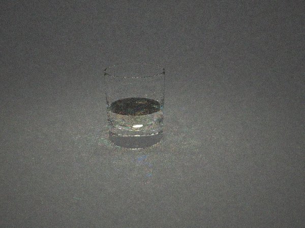

Macrob
Posts: 289
Post by Macrob » Thu Mar 22, 2007 7:32 am
I will give it a try.
Here is what I did since then. The values are from the scattering-new.pdf for Indigo 0.7t2.
Post by Kram1032 » Thu Mar 22, 2007 7:36 am
looks better... but somewhat, if it just was the fat of the milk, without the rest...
DaveC
Posts: 596
Post by DaveC » Thu Mar 22, 2007 7:57 am
Your scattering colour is back to front. click on the blue colour picker and move your mouse cursor away (someone already mentioned this) and it should change to a creamy colour. That's what you're looking for for the scattering. and change the gain to about 1000 for scattering too.
Post by Kram1032 » Thu Mar 22, 2007 8:00 am
I've already said that :P
(And I mentioned this kinda-bug)
Macrob
Posts: 289
Post by Macrob » Thu Mar 22, 2007 8:06 am
DaveC wrote:Your scattering colour is back to front. click on the blue colour picker and move your mouse cursor away (someone already mentioned this)
Now I understand :P
It´s rendering.
Here is what sss gain 1000 did:
Post by Kram1032 » Thu Mar 22, 2007 8:13 am
at least, it now looks... intransparent :D
but it looks too yellowish...
