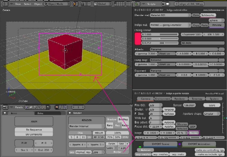

ok in general talk to ono in chat it was mentioned smartden may like an idea for making render region for the official blendigo.
I offer an idea I used making use of blenders border tool - unfortunately I could not see a way to use the shift b rectangle to draw a region for the script to read directly but conversely you can set up the script so that it will draw the border via slider changes to the cameras window realtime for visualising the output - which is all you need really
see pic attach
its not very clear here but I have sliders for left , right , top , bottom position
possibly that works for him too 8)

i got the region render with shift-b and fixed the memory bug with big scenes. but i have still to fix some minor bugs and then i publish the new version. be patient a little bit longer... ;)

BigFan,
How you get that blendigo interface? Is this some sort of your cooking? Could you share?
Big Fan
Posts: 745
Location: Nelson NZ
Post by Big Fan » Wed Feb 06, 2008 6:00 pm
hi Woodie,
its a variant based on an older version of blendigo I keep reheating for use with Solidworks and for Indigo tasting evenings :wink:
its somewhat different now in appearance and slightly different in function from the blendigo available here
I would really rather you use the official blendigo that Smartden posts cos I dont want to maintain it for public use or have a number of versions in circulation causing confusion
