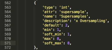

Oscar J wrote:Another minor bug: the max SS value in Blendigo is 4. In some cases I find myself having to crank it up to 5, would be nice to be able to do that in Blendigo.
as I am examining the Blendigo code at the moment this one should be very easy to change yourself.
Go into the Blender User Preferences Panel into the Addons tab and note down the location of the folder where the Blendigo addon is stored.
Navigate to the sub-folder /properties and locate and open the render_settings.py file.
Change the numeric values in Line number 570 & 571 from to whatever value you like (I arbitrarily chose 8 ) , save the file and restart Blender.

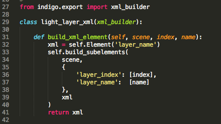

Based on a number of forum posts I don't think it should be modifying the lights output directly. Currently, however, Blendigo is really not exporting or modifying anything in respect to Light Layer Gain. It exports exactly what shown in the python script below, a layer name and a layer index.
Then it references the layer index in the material definition for the emitter. That's it!

As mentioned in reply to FakeShamus Blendigo does to appear to export anything that scales the output of the lights directly. At least there is no trace of it in the exported IGS.
I can set the Lightlayer gain in the Blender World pane to whatever. It does not result in a changed exported .igs.
Looking through the export code I am assuming you are referring to the EmissionChannel class in /export/base.py ?
That code does appear to modify the base emission, but again, that code does not appear to export anything.
However, looking through the Indigo Technical Reference I can also not see how this should be implemented.
