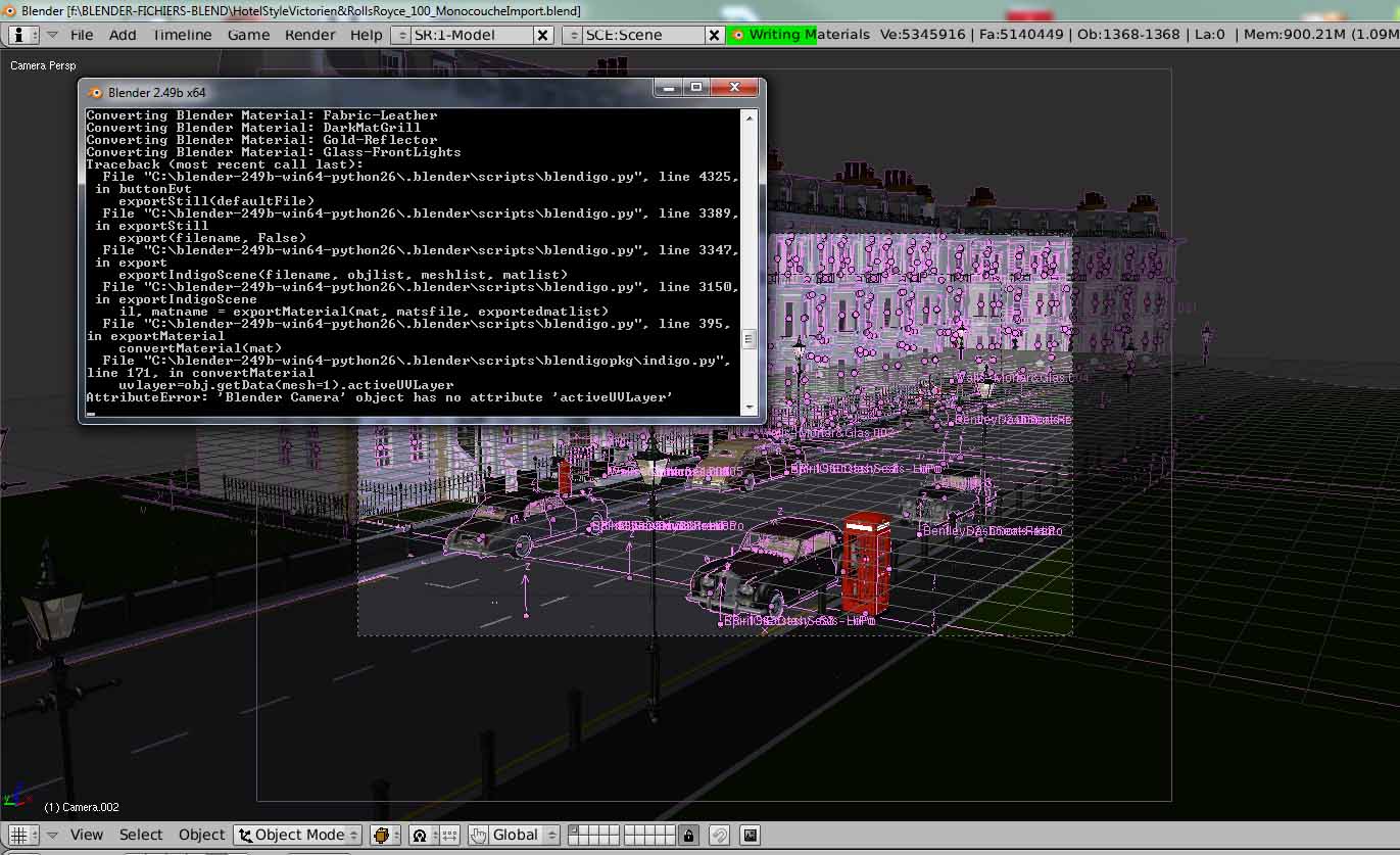

I deleted layers, buidings, cars, by groups, one by one... I got the message no UV layer for the camera...

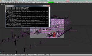

Then I came back to my 10 millions triangles scene : I created an empty blend file, and imported all object to be rendered on one unique layer, with the camera.
I moved them closer to the center of the scene, and moved the camera as well, as I did previously with the simple scene including only a cube and a camera.
I tried to export : Failed and got the message shown on first screenshot below .
Then I deleted the ground/road object that included the faulty material in the previous test. I got an other error at exporting. See screen shot 2.
