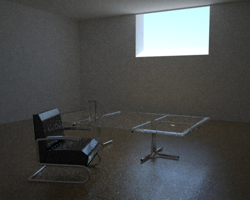

Post by ZachZJG » Thu Nov 20, 2008 6:35 pm
When i try to render my scene, this error occurs: Image
i don't know why. I've removed doubles and recalculated normals on everything. I can't find any mention of this error anywhere else on the Indigo forums.
If someone could download the blend files and then get it to work, it would be greatly appreciated. Just tell me what to fix.
thanks in advance.

Post by ZachZJG » Fri Nov 21, 2008 12:12 pm
Ok i changed everything to 1.1.13 but I still get the "material_index is out of bounds" error.
Update: Ok so i removed the chair model and it starts to work again. (at the time of this posting the renderer has finished the part where it says "Done initial warmup." the render itself has not yet started.)
that narrows it down to the chair model that had the out of bounds material thing. Anybody know what that means?

Post by ZachZJG » Sat Nov 22, 2008 11:49 am
I thought you meant the glass on the table. Ok that helps me when i get the final render, but what about the error i get? I narrowed it down to the chair model, but I don't see what is wrong with it.
Everything renders without the chair, but with the chair I get the error.
I also can't render the chair by itself.
what exactly is a triangle material_index?

Post by Big Fan » Sat Nov 22, 2008 4:34 pm
here is a quick fix up for indigo 1.1.14 should be ok for other versions just dont use my script :wink:
Items fixed:
exit portal - flipped normal - must be inward (also tidied to be rectangular - but not important)
end wall - tidied up overlapping geometry around window and wall end - gave edge split modifier
window glass plane - deleted (if you did have glass sheet it needs to be offset from the portal by at least the "nudge" distance)
chair - removed doubles and separated mesh parts with different materials
walls - extruded to make light tight at corners
table legs - convert curves to meshes
floor - apply scale and rotation
environment -apply world scale of 1/10th
removed various redundant object/material shares
(sorry materials are slightly different - removed textures for the quickie trial render - need to do these to suit your blendigo version)
+ maybe other stuff cant remember ATM
HTH

Post by ZachZJG » Sat Nov 22, 2008 11:20 pm
Thank you so much, Big Fan.
So whenever an object results in a material_index error, I should remove doubles and seperate it into smaller meshes?
P.S. Thanks for tidying up my wall modeling. I am not very good at modeling.

Post by Big Fan » Sun Nov 23, 2008 7:21 am
the 'degenerate triangles' message in indigo is usually an indicator of 'doubles' in the blender mesh
-you should remove doubles where ever you get that warning as a first solution - it usually fixes it
-sometimes it happens because the modelling is otherwise 'unusual' - your wall window could be a candidate.
get into the habit of 'removing doubles' and 'applying scale and rotation' in your scene preparation
I havent looked to see how smartden has changed his script code lately but the material index error probably is related to having a mesh in blender with multiple materials assigned
In this case to fix it I just separated the parts of the mesh according to material -ie its not the size thats the issue...
You can do this in edit mode using the 'link and materials' panel to select the vertices with the same material then shortcut "P"
Most probably smartden should investigate the issue properly.
BTW another pointer- be careful not to overdo the degree of subsurf - it can slow down blendigo export a lot to generate a lot of most likely unnecessary triangles
the chair leather is a case in point - you have edge loops near the corners that restrict the rounding of the object during subsurf and the object is pretty prismatic anyway so a ss of 2 doesnt achieve much
keep up the good work
