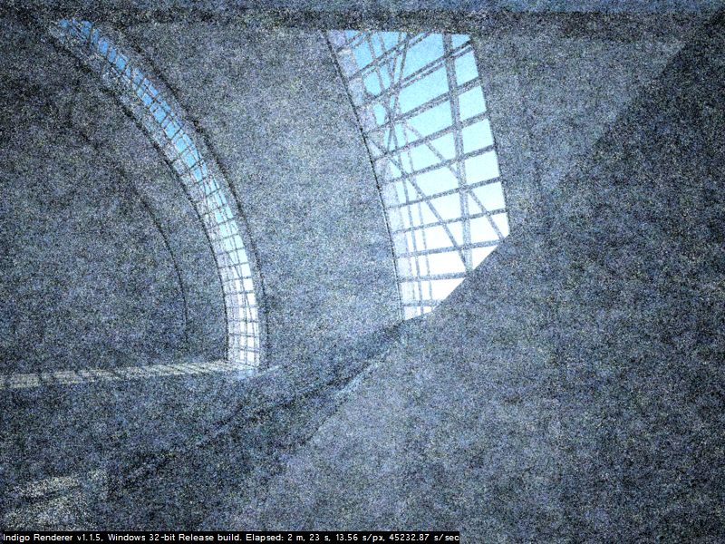

INDIGO MASTERS! I NEED YOU HELP! :(
BLENDER MODEL: http://zeldaoca.tripod.com/Concurso.blend RIGHT CLICK> SAVE
Ok i want to render this model, but i got this for the first time...
Then I found out that I didn't put an Exit portal.. (i'm so stupid)... But I got this...

My guess is that you've got the camera focal plane set wrong, so you're focussing on a point that's either much too close to the camera or far behind your model. I did that once :P .
Post by Borgleader » Wed Aug 06, 2008 2:23 pm
Well first you shouldn't need an exit portal. It just makes things quicker sometimes (rendering that is).
Man that is really weird. At first i thought your DOF was fuxorred so i change it to where the staircase is. Then I figured (onh maybe the sun lamp is too far) no effect...then i figured (hey maybe the material sux) cuz its the basic gray one, well turns out its not that either. its realllly weird.
but in the end. its your camera's position that "sux". put it inside the
staircase and make it face the window. you'll see something.
now why does your camera position suck? because its INSIDE the wall :lol: or at least thats what it looked like.
well anyway, hella nice scene you got there :) but for god's sake pleae texture it a little!!!! or i will :wink:

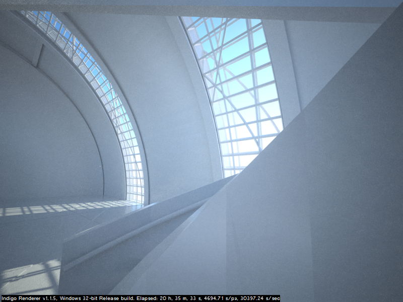

P.S: Mind if I render it for a while? just for the sake of it. willl give results tomorrow (if you mind ill stop it and "burn my computer")
Heres what i was talking about (inside stairwell facing window)
Post by StompinTom » Wed Aug 06, 2008 2:27 pm
seems to render alright with me....
only thing i did was apply scale to all objects in the scene (ctrl-A) and move the camera inwards a tiny bit. lemme know if that does it.
Post by Borgleader » Wed Aug 06, 2008 2:28 pm
StompinTom wrote:seems to render alright with me....
its probably the "moving it inwards a bit" could you try it again but just scaling? because i RLY think the camera is inside the wall in his file.

Post by kikeonline » Wed Aug 06, 2008 2:32 pm
OH!!!
Let me try that right now!!! :o :o :o :o

Post by StompinTom » Wed Aug 06, 2008 2:38 pm
haha yeah just checked. if you look real closely, you can see that the camera is just OUTSIDE of the wall. the wall lies right between the cameras position and the start of its clipping plane, that is why you can "see through it" except when you render it. Indigo doesnt put up with no clippin planes! (unfortunately... ;))

Post by kikeonline » Wed Aug 06, 2008 2:43 pm
LOL :lol: LOL :lol:
8)
Tha problem was the camera exactly in between the wall...

Post by Borgleader » Thu Aug 07, 2008 10:57 am
Heres that render from the other day
Inside stairwell shot

Post by kikeonline » Thu Aug 07, 2008 11:56 am
And here is mine :D
Post by Borgleader » Thu Aug 07, 2008 12:00 pm
Holy shit NICE! :)

Post by ViennaLinux » Thu Aug 07, 2008 7:54 pm
its such a beauty ... damn i really need to concentrate on modelling.
I always waste my time with indigos material settings and preview renderings :-(
