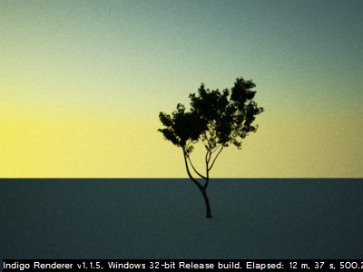

Below is my test render using sun's angle quite close to yours.

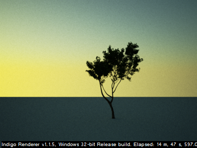

Camera tonemapped, ISO 100, Exposure 1/1000, F-Stop 8, White balance E, EV 0, Sun angle....same as my previous image.

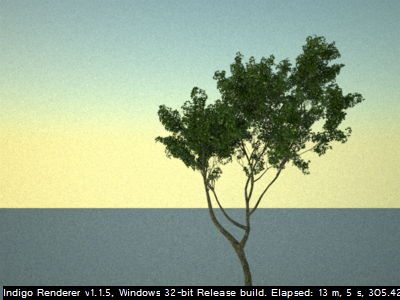

Camera tonemapped, ISO 100, Exposure 1/125, F-Stop 22, White balance E, EV 0, Sun angle....same as my previous image.
