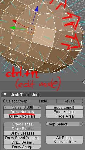

Post by aleksandera » Tue Jun 17, 2008 8:58 am
Well that's the most frequent one.
Check your normals!
Do they point outside?
Normals copy.jpg (152.75 KiB) Viewed 2807 times
Post by Kram1032 » Tue Jun 17, 2008 9:23 am
I see...
you need to subdivide your mesh further. It's extremely edgy!
In 0.5, Normal Smoothing was temporarily disabled if I remember correctly, so the smoothness of the mesh wasn't that important.
Use the subsurf modifier ;)
