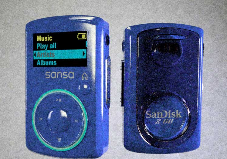

Hi,
I've had a problem with transparent materials.
I'm rendering an MP3 player with a transparent clip on the back.
I had a few other problems with materials but I've searched the forums and managed to nail them all down. I just have this one problem with the transparent clip on the back of the player.
It always renders as solid black. There was a thread where it was mentioned as having happened on the transparent face of a clock, but nobody replied to it.
Here is a list of things that I've done:
Highlighted all vertices and then Cntrl - N for recalculate normals outwards.
Recreated the material from scratch.
Created a new document and appended the player into that.
Tried diffuse and specular transparent materials.
Does anyone have any idea what is going on here?

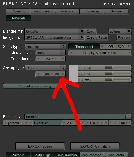

Take a look to gain of trasparent material...
Luca. ;)

Thanks Pinko5. I tried that, but its still doing it.

My first thought was the same as Pinko, try setting the gain to really low (say 1 or 2) as a test render?
