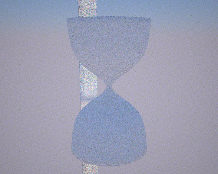

Hey y'all,
I'm currently working on this project which involves an hourglass full of colored red water which would drip down into the lower part. I haven't started the FluidSim part just yet, and am just trying to render the hourglass and the liquid in Indigo, but I seem to be running into some trouble. I'm such a newbie, hopefully my sort of question hasn't yet been answered in one of those threads... (I searched the forum but didn't seem to hit on anything relevant).
Here's the blend file, so you can know what I'm actually talking about...
http://rapidshare.com/files/78699500/Sp ... blend.html
I know I still have to turn all the Blender lights into emitter planes, as they're not fit for Indigo (the project's still in its early stages, and I first tried rendering with BlenderInternal).
Indigo doesn't seem to render the liquid inside, and the body of my hourglass is not transparent (it roughly reflects the sky)... I don't know what I'm doing wrong, although I did try to heed all the advice I could find in Indigo manuals or tuts (I've been working on that hourglass on and off for a month now. And have started anew a countless number of times...): I modelled the liquid overlapping the glass, modelled the meniscus, set up my materials so that the glass had more precedence than the water (because glass displaces water). I even tried cranking up like mad both Max Num Consec Reject and Max Depth (although I'm not even sure I understand what they're about) as I seemed to read somewhere on the Indigo website that they both controlled the number of light bounces and how biased Indigo is (so I upped it all thinking I didn't care for computation times for the moment, and that I would see later...)
Even the "wooden" stick I put there temporarily to check whether the glass & liquid refracted correctly is blueish, when it should have a diffuse ocre-ish material. I must be doing something wrong big time....
Thanks for your help,
Ari ;o)

Yeah, well, that's exactly what I don't understand. Look at the blend file, I can assure you that the glass is thick (I modelled it the way they said it should be), and the materials have been exported with careful settings (I'm sure of that because I've been tweaking the precedence bit, and then all the rest around it.)
Anyway, as the materials were already defined in Blender, they get exported (sort of) into Blendigo, and I usually just need to fine-tune them. Well, they did get exported in the Blendigo script window (as I remember modifying some settings), but they don't get exported to Indigo apparently, which in turn, does not render them, but a diffuse gray instead.
I'm really drawing a blank here. Is this a bug?!? How could I make sure Indigo does get the materials I defined in the exporter window (without having to code a damn XML file...)?

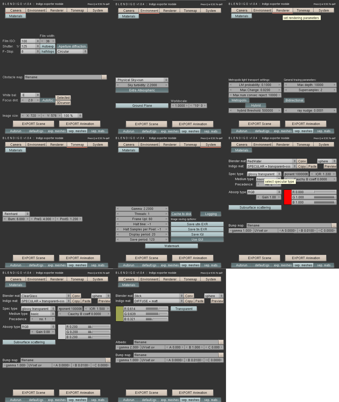

Here are my precise settings...

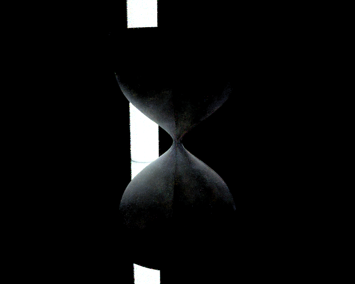

Things keep getting weirder every day. I decided to start rerendering today to check whether all my settings were correct and I now get something "different", to say the least (check out that wonderful black picture with a white glowing stick!)
I really don't know what I'm doing wrong, so I decided to post a screencap of ALL my Blendigo settings when exporting. Hopefully you guys can spot my mistake and tell me how to fix it. Thanks SUV & KRAM for your advice, and I did change precedence order, when I suddenly realized "no." meant "number" (DUH!). So as you'll see, glass is now 1 and water is now 2.
Again, thank you for your help and time.
Ari ;o)

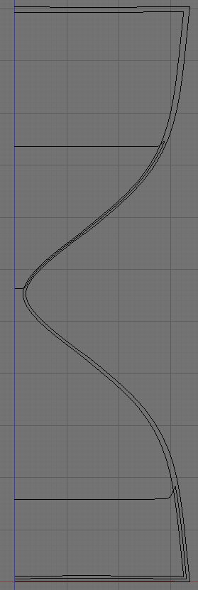

@ Kram: I don't know what PT is but from the settings you can see I used Hybrid AND Metropolis (if that's what MTL means...). I also included a screencap of the curves I drew to spin the hourglass and the liquid inside, so you can tell me whether they are adequate...

Specular instead of Glossy Transparent doesn't seem to work any better, I'm afraid. Everything is still rendering black except for white glowing stick (I so don't understand why the stick wants to emit light BTW as it's got a diffuse shader...)
Ah ha...Your normals on the INNER glass mesh and the TOP liquid mesh are inverted.
edit: compare this hourglass with your one and you will see...

I have solved your problem for you. First, as mentioned by neepneep, your normals on the inner faces of the egg-timer are facing the wrong way. select them and flip them. Secondly, your egg-timer is over 11 meters tall. Very thick glass. Scale it down to 0.02 of it's current size and apply the scale. Then try it again. It should work. It did for me
