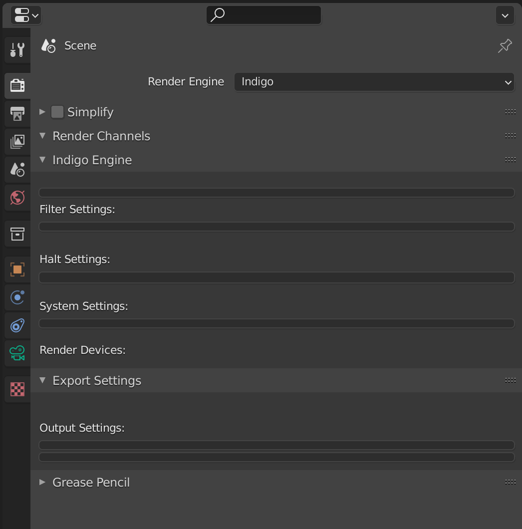

Re: Blendigo not functional for Blender 2.93LTS and 3.0
This is all I get...
I also have BlendLuxCore installed, but that should not be an issue.

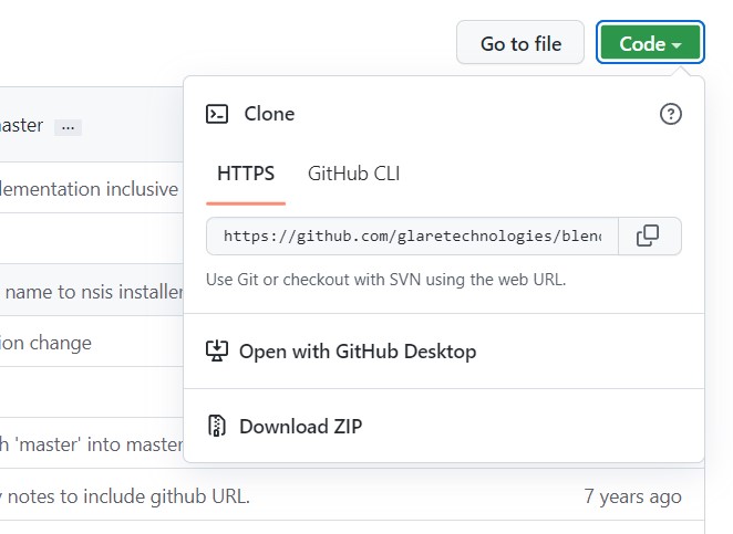

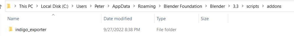

If you are working on a Windows computer, Blendigo is located in your user directory. Obviously you'll have to replace my user name with yours

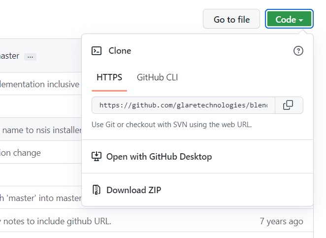

Then on github you can download the Exporter sources as a Zip file: Unzip that file and in the "Sources" folder you'll find the same "Indigo_exporter" folder.
Simply move the folder and its contents into the aforementioned user directory and start Blender.

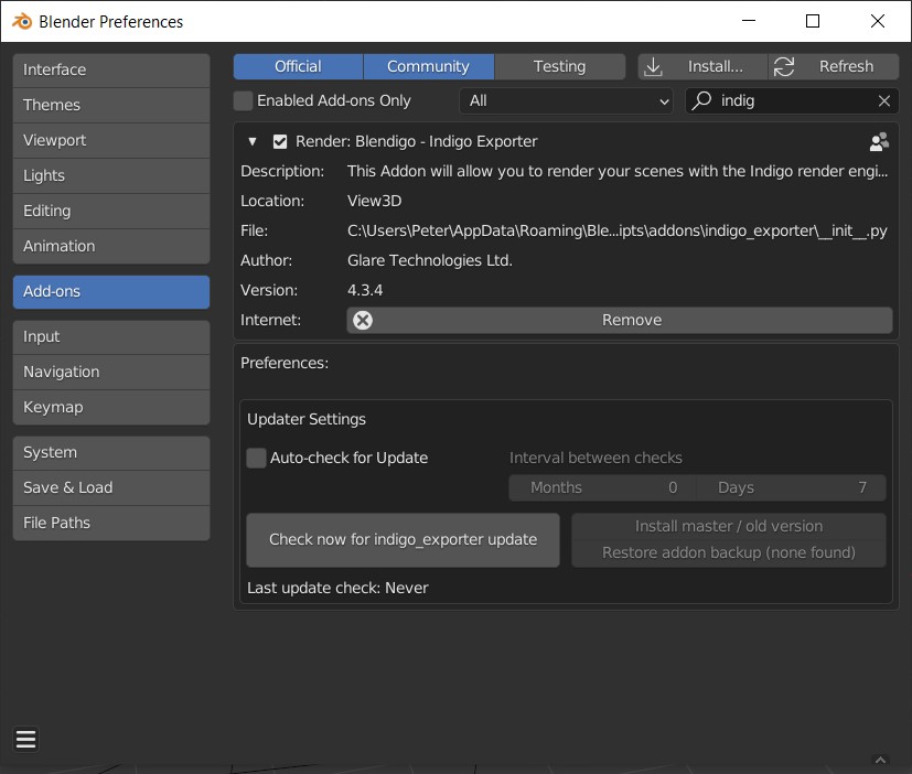

The plugin should then appear in the Addon section of the Blender preferences and needs to be activated:

The latest Blendigo Exporter is 4.3.4 and works with Blender 3.3. It also works with the previous beta of Indigo 4.6.0.

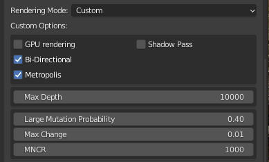

I changed my own copy of the exporter and added some parameters to the Blendigo UI. This required only minor changes to two files in the Exporter sources and I can share those if there is interest. I've also contacted the maintainer of the exporter of the Github repo to see if he's interested in adding these to the Github repo.

And finally for those few that still use BIDir MLT, when the render mode is set to custom and Metropolis is enabled the following parameters can be edited:
