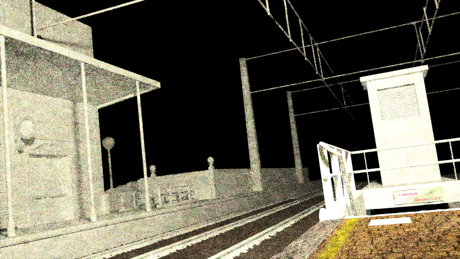

I'm working with this scene, but I want the emitter (that is not visible in the render) to be less powerful, so it won't reach the other side (left side) with so much intensity. I keep changing values, but it won't work :S
Cheers.

You use reinhard tonemapping, right?
Switch to linear :)

also try using efficacy scale option for emitters

Don't forget that your WorldScale value affects your emitter power as well. A 300W light at a scale of 1.0 isn't going to be as bright with a scale value of 0.1
