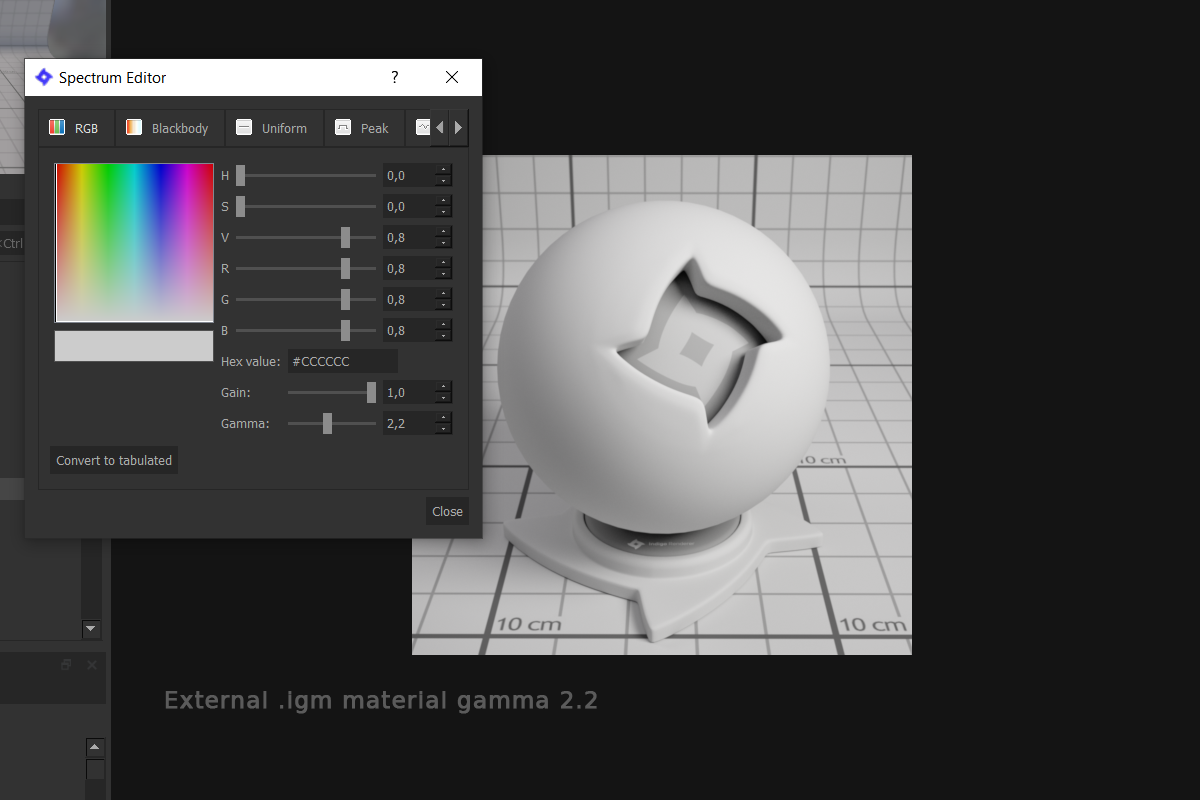

I am looking through the exporter code to see if this behavior can be changed. In the meantime, would an external material work ?
Re: colors in blender vs indigo
As an external material the .igm file would look like this:
<scenedata>
<material>
<name>diffuse_white</name>
<diffuse>
<albedo>
<constant>
<rgb>
<rgb>0.8 0.8 0.8</rgb>
<gamma>2.2</gamma>
</rgb>
</constant>
</albedo>
</diffuse>
</material>
</scenedata>Re: colors in blender vs indigo

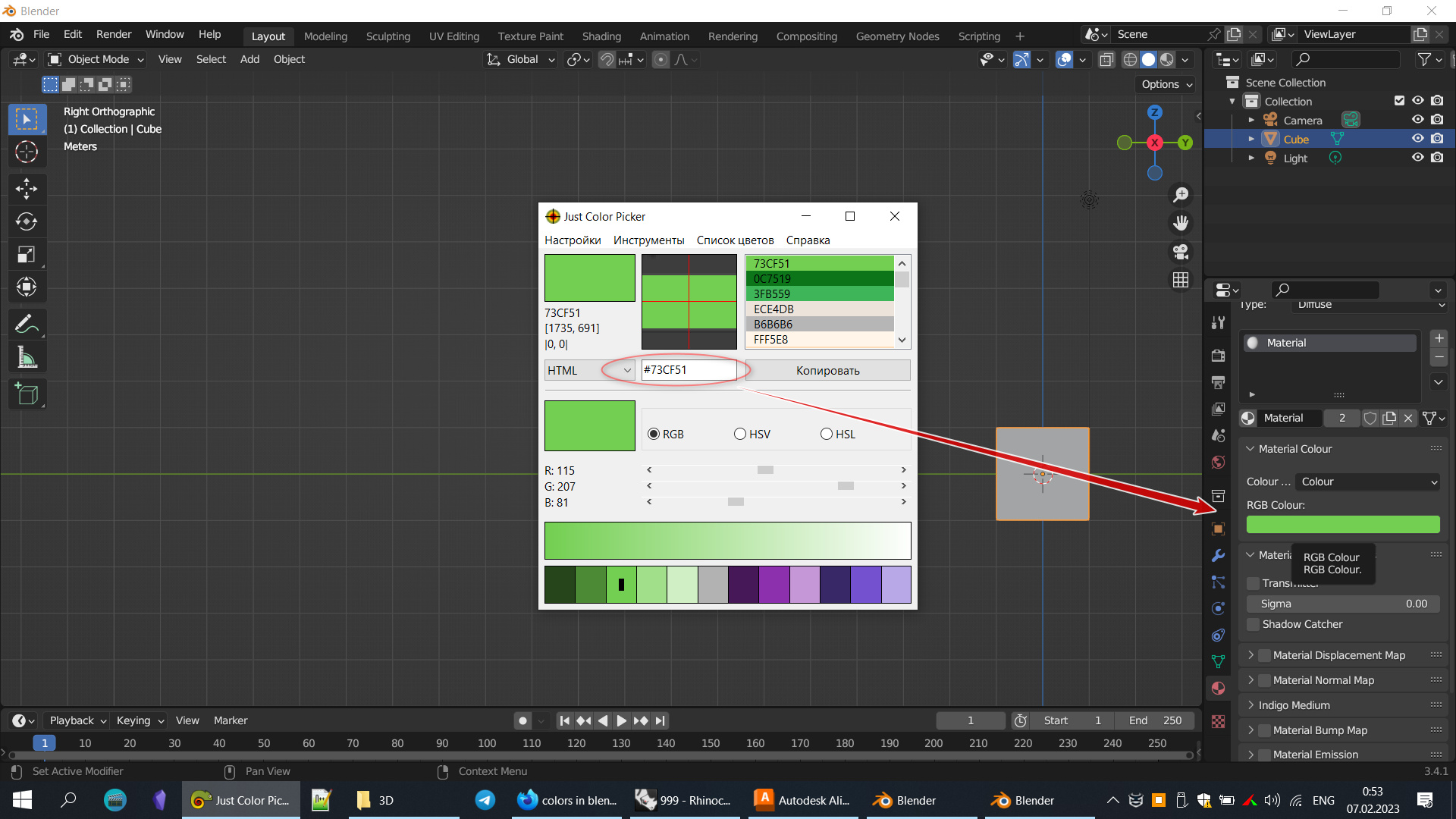

#73CF51 color after export #2B9F14
"Blender use linear space" apparently this is the reason for the color distortion.
