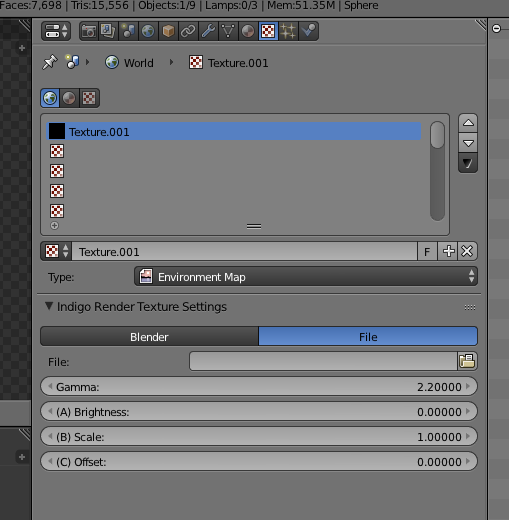

:o Think I found it. Just go to the texture-tab and select 'world'.
Then click 'add' and set type to 'environment map', might not work for the RT-Version,
for there is no light-layer support....

Hey steven, just add a hemi light source and go to the light tab. Change type to env-map and select the hdr, you might also play with gain/put it on a layer Rotate the hemi light to rotate the env-map until it fits your needs.
