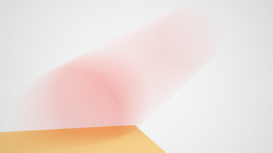

Ah good, that confirms what I suspected. It got something with the way Blendigo exports the scene. But looking at the exported scene file (.igs), I can't find any reference to something that may look like "Motion Blur". I even compared the files within Notepad++ without success.
I created a file with an ICO sphere and the cam moving (obviously in different directions). I can see clearly the sphere blured (a lot) and a fixed cube totally cristal clear. Since the CAM is moving quite fast, the cube should be blurred as well.
Where is this value set. And How Blendigo could have set motion blur on objects but not the camera. That would mean that motion blur can be set either on :
1. All objects on one side and the camera on the second
2. Each objects individually (which could actually be usefull in certain cases) considering the camera as an object.
It would have to do with the way Blendigo sets this parameter for each exported objects. I checked the (.obj) file and can't get any more success there...
Obviously, I'm a newby on the coding side. But I can't imagine this would be complexe to fix.
As for Particules MB, could the problem be related. Would it just be that each particules, when exported, are not set to be motion blured...
Am I completely beside the track here?
