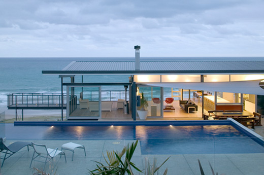

Hi,
i have been really doing a -lot- of research before posting this message, believe me when i say that i look high and low before posting!
at the moment i am trying to render a scene that has a normal sky and a building that is lit inside, and the lights inside need to show up.
the sun is drowning out everything! my scene is basically a "box" with one opened end which is a face with a transparent glass material. inside this box are meshes with emitter materials.
I want a semi-bright sky with the inside lamps showing through as lighting up the inside (see examples).
Can someone give me a description of how to set up the scene?
Thank You ever so much...
Attached are some example / reference pics.
