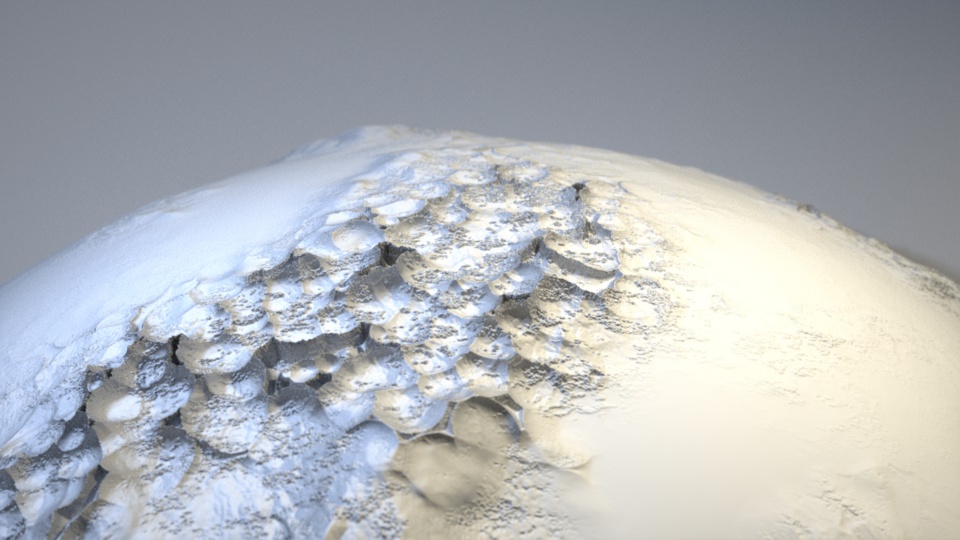

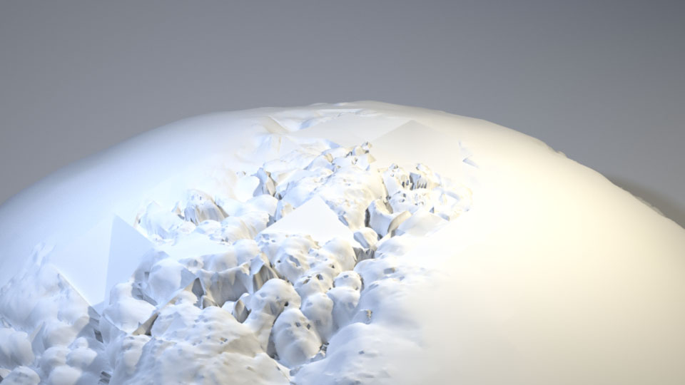

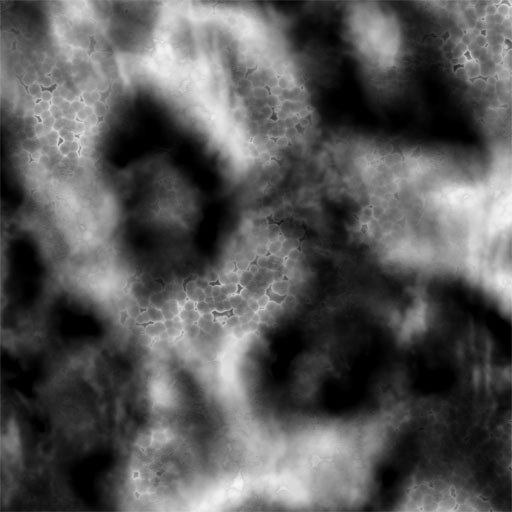

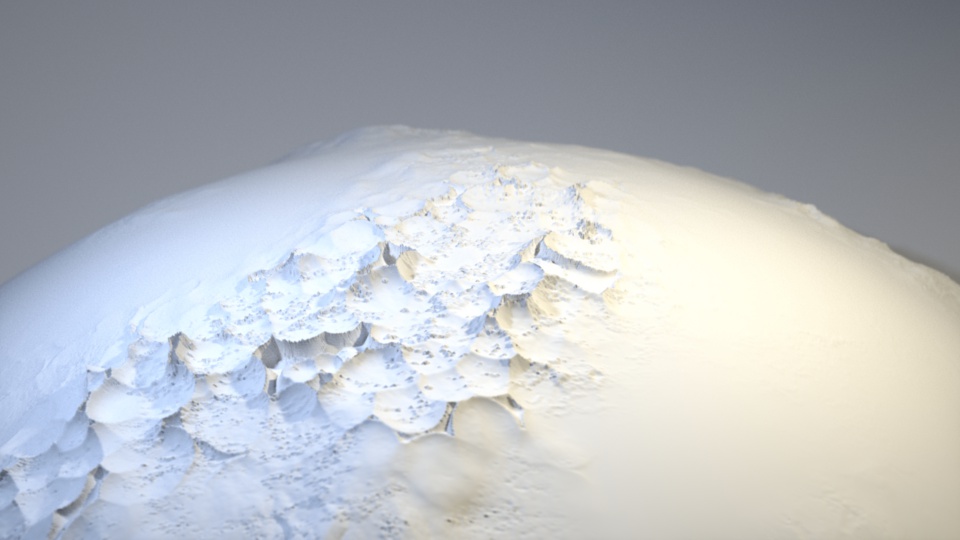

I'm not sure that this is specifically a Blender issue, but since I'm using it I'd thought I'd post here.
Here's my problem. I've used the following black & white texture below as a displacement map with positive and negative scale values, and the results were less than satisfactory. Even with up to 7 or 8 subdivision levels, the results are still unimpressive. It appears as if the displacements were executed in Blender's native renderer.
However when used as a bump map, the texture came out as expected. Doesn't Indigo support micropolygon displacement? In another project where I used Luxrender, my displacement came out very well as it looked like a more realistic & tactile version of the bump map render.
Am I doing something wrong or does Indigo not render displacement textures that well?
Bump & Displacement Map
Displacement Test 1
Displacement Test 2
Bump Test 1
Bump Test 2
Re: Displacement Help?
Post by CTZn » Wed Jun 27, 2012 3:31 am
Hi Kwayde
Try increasingly higher subdivision levels to get finer details, and use 25% of the test value to match the bump mapping better.
Indigo used to adapt the displaced meshes density based on the view but this feature was removed when realtime edition was added to Indigo 3.0. It's a severe loss in the field of displacement if you ask me, since plausible polygons-based landscapes are virtually excluded at this point.

Wich is to say that micro-polygon displacement is available for everyone out of the box but Maya users, because MtI is still using the external OBJ format for meshes.
So Kwayde, use the view-dependent subdivisions option from your exporter to allow a screen based minimum size for the generated triangles. You will need a much higher maximum subdivisions count; the key then is to throttle further subdivisions by the minimal pixel width allowed for triangles.
A starting value of 3.0 (pixels wide) should allow your computer to pass through. There's not much point in generating triangles below a width of 0.5px, and that's an extreme setting already.
Keep in mind that with the view-dependent option, Indigo will keep subdividing triangles, until they hit the maximum subdivision limit OR go below the minimal width. All in all after the right balance is found you will be able to render more geometric details at a lesser cost.
Kwayde
Posts: 10
Joined: Mon May 14, 2012 8:17 pm
Post by Kwayde » Wed Jun 27, 2012 6:34 pm
Hi Ono & CTZn,

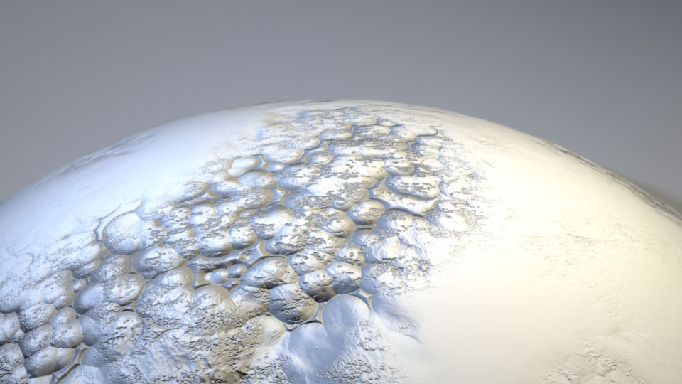

Thanks for your input. I think my problem was that I had not enabled View Dependent Subdivision & Subdivision Smoothing. Also, by changing my Subdivision curvature threshold to 0, I was able to achieve the desired result. Still unimpressive in my opinion.

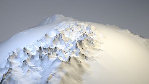

Displacement Test 1
Displacement Test 2

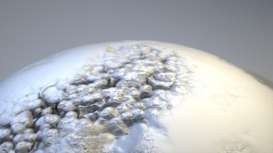

But when I enable the texture for both bump & displacement it looks rather interesting!
Bump & Displacement Test 1
Bump & Displacement Test 2

Your material is too white, you will have stronger shading by using lowering diffuse.
I think this is why disp+bump looks interesting : it accentuates (exeedingly) the shading and adds energy loss. But this would be achieved in a more realistic way by using less pure white material

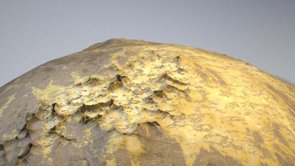

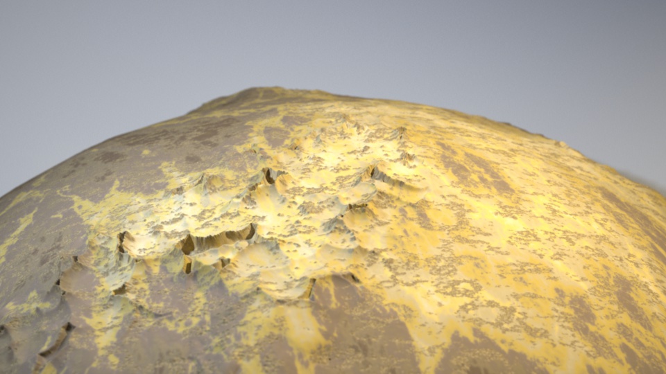

Kwayde
Posts: 10
Post by Kwayde » Wed Jun 27, 2012 9:01 pm
galinette wrote:Your material is too white, you will have stronger shading by using lowering diffuse.
Etienne
Hi Etienne,

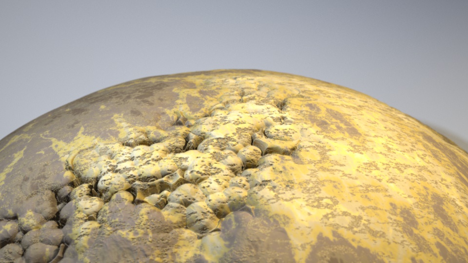

Yes I thought the bump made it look better by increasing the contrast & sharpness compared to the displacement render alone. I used your suggestion and added the color map to the displacement render and these were my results.
Color & Displacement 1
Color & Displacement 2

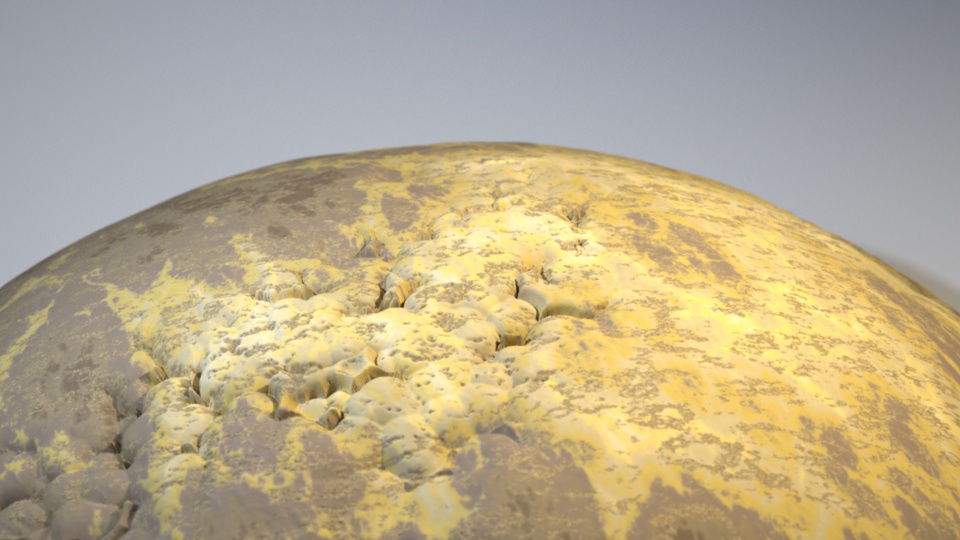

Below are the results of the bump, displacement, and the color maps. I reduced the strength of the bump so the contrast wouldn't be too strong.
Bump, Color, & Displacement 1
Bump, Color, & Displacement 2
How does it look?
