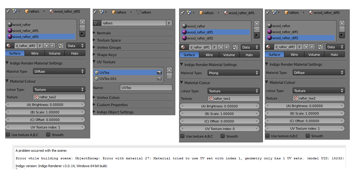

Couple of days ago I've started playing with Indigo Renderer and really like it.. But today I've stumbled upon a problem with rendering object with multiple UV maps assigned.
Presumably I'm doing something wrong here:
1. I've created 2 UV maps - one for each texture.
2. Created blended indigo material with two submaterials as on screenshots: each of them has a different texture with different UV Texture index assigned.
When rendering it errors that geometry has only 1 UV set?
Any ideas what I'm doing wrong here? (Blendigo 3.0.14.0)

Hey haluperido, I cannot reproduce this in blendigo 3.0.14.1. This version does have trouble with uv sets and smooth shading, but multiple uv sets work with no problem.
What has changed is that you don't set a "uv index" in the materials panel, but you enter the name of a specific "uv set". From the screenshots it seems you did everything right.

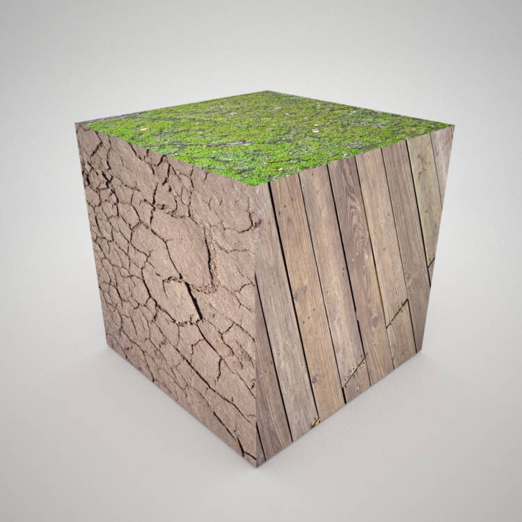

I attached a simple picture: default cube, three uv sets, three materials, three random textures - works for me.
Did you leave edit mode? Sometimes indigo doesn't seem to catch all the changes you do in blender while in edit mode.

I'll check latest blendigo tomorrow.. during the day I've figured out that UV index is just the index for for material slot in blender material panel, and I couldn't find any way in blendigo where u can assign name of the UV set except using material editor from v2.4
What I've been trying to achieve is to create indigo blended material, where material A and B (I've called those "submaterials") are different textures assigned to differently mapped UV sets on one object... After a while I've figured out this is bit pointless because you cannot set blend mode (add,multiply,overlay etc.) between those materials like in Blender Internal (can you?) and I wont get texture effect I wanted anyway..

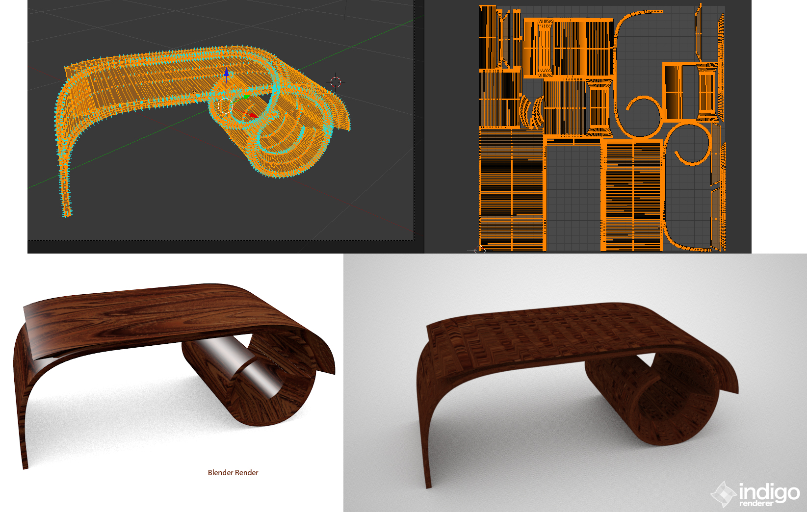

Hi, it's me again with another UV problem, Ive decided to continue in this thread to not spam the forum too much
This is probably some trivial mistake I'm doing, but can't find any way to sort it unfortunately.
I've created random coffee table model, whilst it's not even half way finished I've applied UV mapped texture on it when modeling in blender and it seemed ok until I've tried to render it in Indigo - take a look at attached screenshots. I've got no idea what I'm doing wrong. Normals are fine, I've tried various unwrapping modes, but nothing seems to work on that mesh, texture always looks zigzag'ed...
Any ideas? (Blender 2.59.4, blendigo 3.0.14.1)
here's blend file: http://hotfile.com/dl/132774137/6f7ece9 ... blend.html
Re: Problem with multiple UV maps
Smooth shading bug.

Hi dag, thanks for quick reply!
But does it mean I should wait for the bug to be fixed and use flat shading with increased number of subdivisions on the mesh for the time being?
