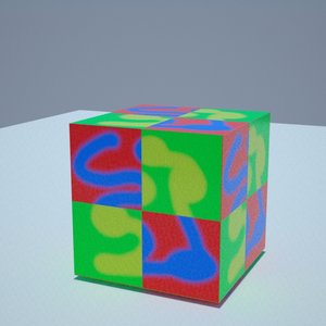

For example to test this out I created a 3x Blend material in the editor and then rendered a simple cube using it. Worked with no problems
3x Blends in one material
The simple scene using the external 3xblended material
