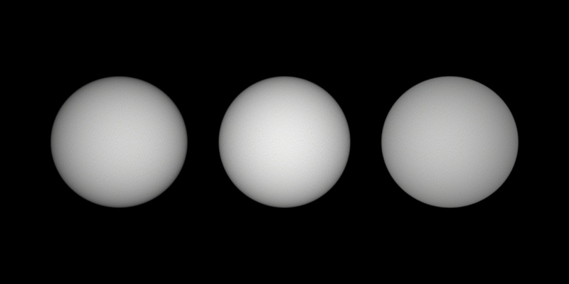

Post by fused » Wed Dec 16, 2009 9:08 pm
like the wikipedia image. 0, 0.1, 0.3

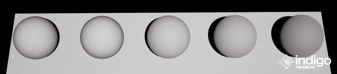

Post by CTZn » Wed Dec 16, 2009 9:48 pm
I wasn't either under the same impression than you, polin and lyc. Higher sigma seems to darken the surface, however if you observe closer you can see that the dark rim edges are also fading away, see below.
I'm fine with the actual implementation :)
diffuse - 0.0 - 0.2 - 0.5 - 1.0

Post by Polinalkrimizei » Wed Dec 16, 2009 11:42 pm
Thanks for the clarification guys.
CTZn, your image made it pretty clear and now I think I got it! :wink:

Post by Zom-B » Thu Dec 17, 2009 1:23 am
clearly visible the higher the sigma the darker the material gets!
This is something I never understood... :oops:
