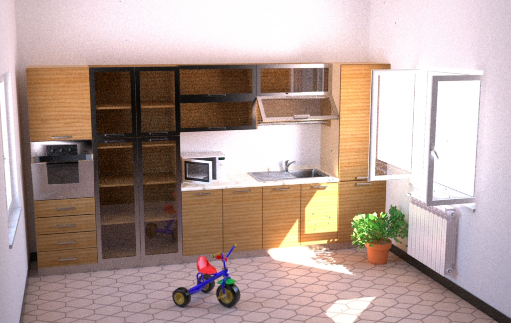

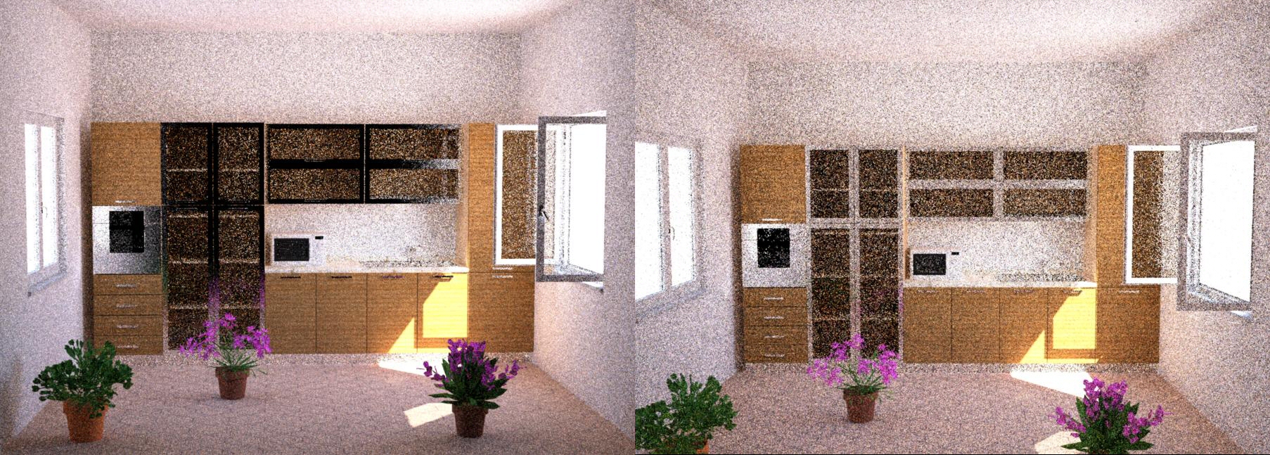

Hi, I use Indigo to render interior scene but I have this problem:
1) If I eliminate the back wall (to place camera outside the room), I get a good shot but reflections are incorrect (e.g. black background) -> left Image
2) If I add the back wall, I have to place the camera inside the room, so I must create a longer room and I have to enlarge the viewing angle of the camera, in this case I have to create a "fake" room and I get a "non real" view. -> Right Image
Is it possible to add an attribute to objects, such as, invisible_to_camera to create objects that are not visible to the camera (e.g. Wall and furnitures near those walls) but visible to reflections and lighting calculations?
Thanks
A. Delle
Back wall missing.JPG (1016.25 KiB) Viewed 23004 times
Post by Kram1032 » Tue Sep 16, 2008 2:16 am
You have to see it like this:
removing the back wall and putting the camera a bit more outside on one hand means, you can stay with the real room but on the other hand also means unrealistic cam position ;)
No, it's impossible, currently... And for some reason I doubt, Indigo'll be able to do it in the closer future...
What's the problem with the back wall? Can't the room just be a tad longer? Is it measured data, you're using?

Post by delle » Fri Sep 19, 2008 6:53 pm
Here is an "improved" version...
Bye
Delle

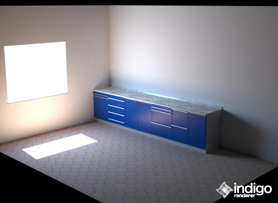

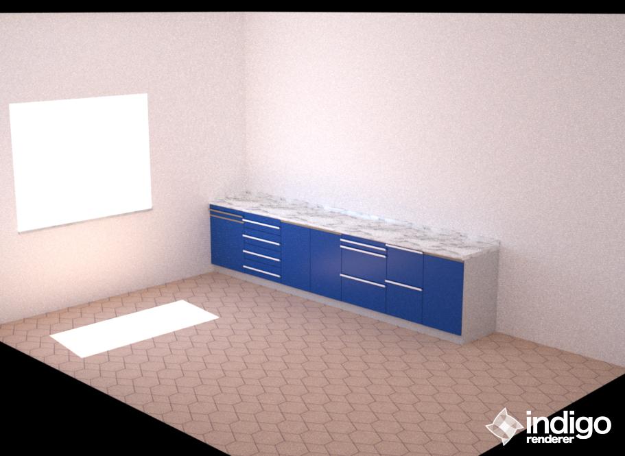

Post by delle » Thu Jun 12, 2014 1:38 am
Hi, I've finally implemented the feature "<invisible_to_camera>true</invisible_to_camera>" present in Indigo 3.6.22 in My Application.
I was waiting since 2008.... :lol:
This is the first Test
The image "No walls and ceiling" has only two walls and one floor (not using "invisible_to_camera")
The image "All walls present" has all walls present but two walls and the ceiling have the option "invisible_to_camera" active
Thank you Ono
Using "Invisible to Camera" option
Missing Walls
