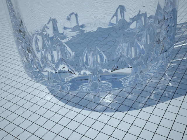

I try the faces solid. It's fragmented as expected (gorgeous caustics!). Considering it is subsurf'd to 200k faces it should look better than it does - But - it behaves as you'd expect.

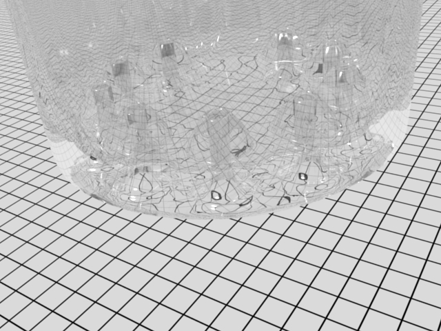

I set the faces to smooth, and all hell breaks loose. Just look at that mess.

envelope, Blender, smooth face normals
envelope, Indigo, smooth face normals
envelope, Indigo, solid face normals

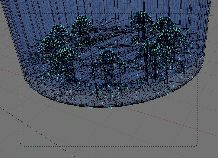

envelope in Blender, face edit mode

edit : by the way, your normals look weird at the bottom of your bottle, on the "edit face mode" picture. If they are bugged, you could try CTZn's tip (c)2006 to export your mesh in obj format and then to re-import it.

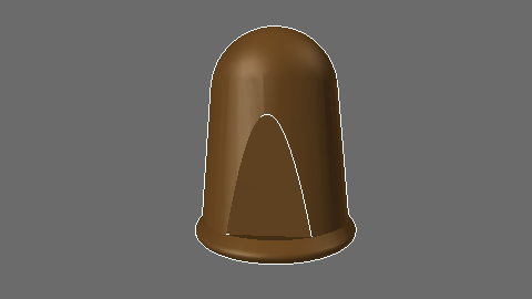

um yeah you can often do that but I was thinking of one I had recently shown in the attach pic
in this case it was easier/faster to select the faces of the parabolic areas and separate them cos the edges faded out... :roll:

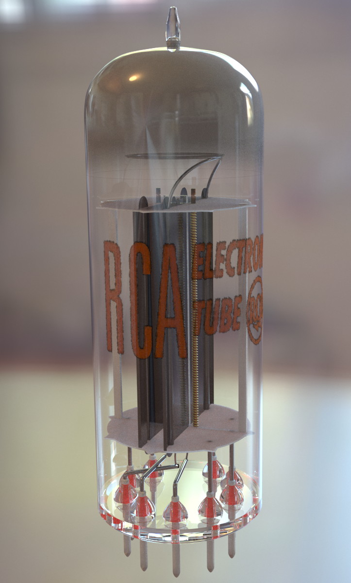

Post by Heavily Tessellated » Sat Sep 22, 2007 4:58 am
Nope, all good. My second set of eyes are all of yours, as it were. The edge split modifier took care of all of it... I was doing a test render of the full tube checking the glass, but DAMN I'm really happy with my SSS "mica" insulator wafers. That's schweet.
One textural thing that bothers me, the mirror gradient has a hard line at the end of the fadeout, when the UV end less than the edge, and the matte is definitely full white at the end? Ah well, not related to the topic of the thread... the glass looks correct.
