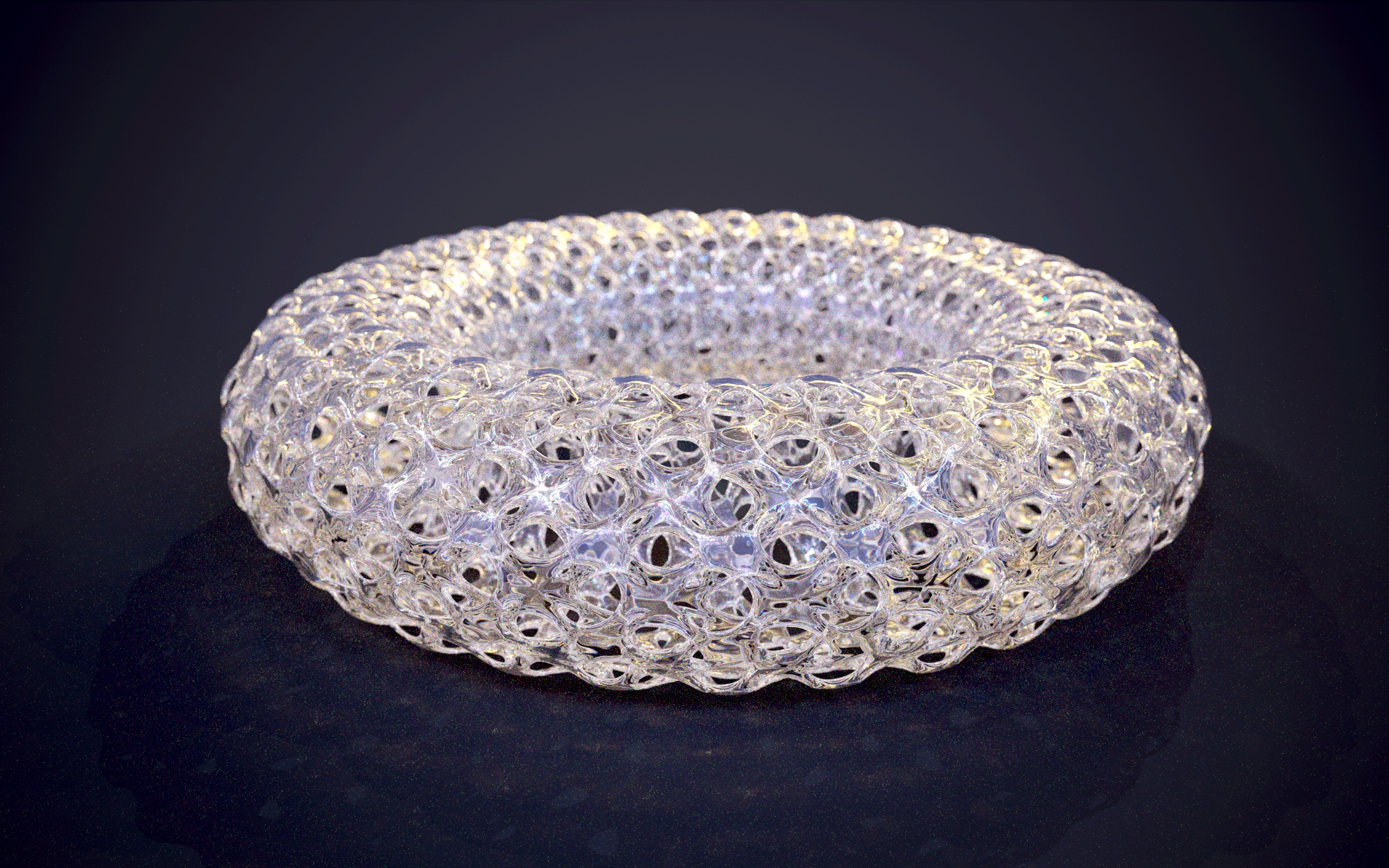

This is a complex object and even when rendered with "normal" materials takes a while to "clean up". However, nothing beats the visual complexity of glass materials with couchy B. The object is lit by a 4k HDRI form HDRI haven called the Shanghai Bundle https://hdrihaven.com/hdri/?c=outdoor&h=shanghai_bund

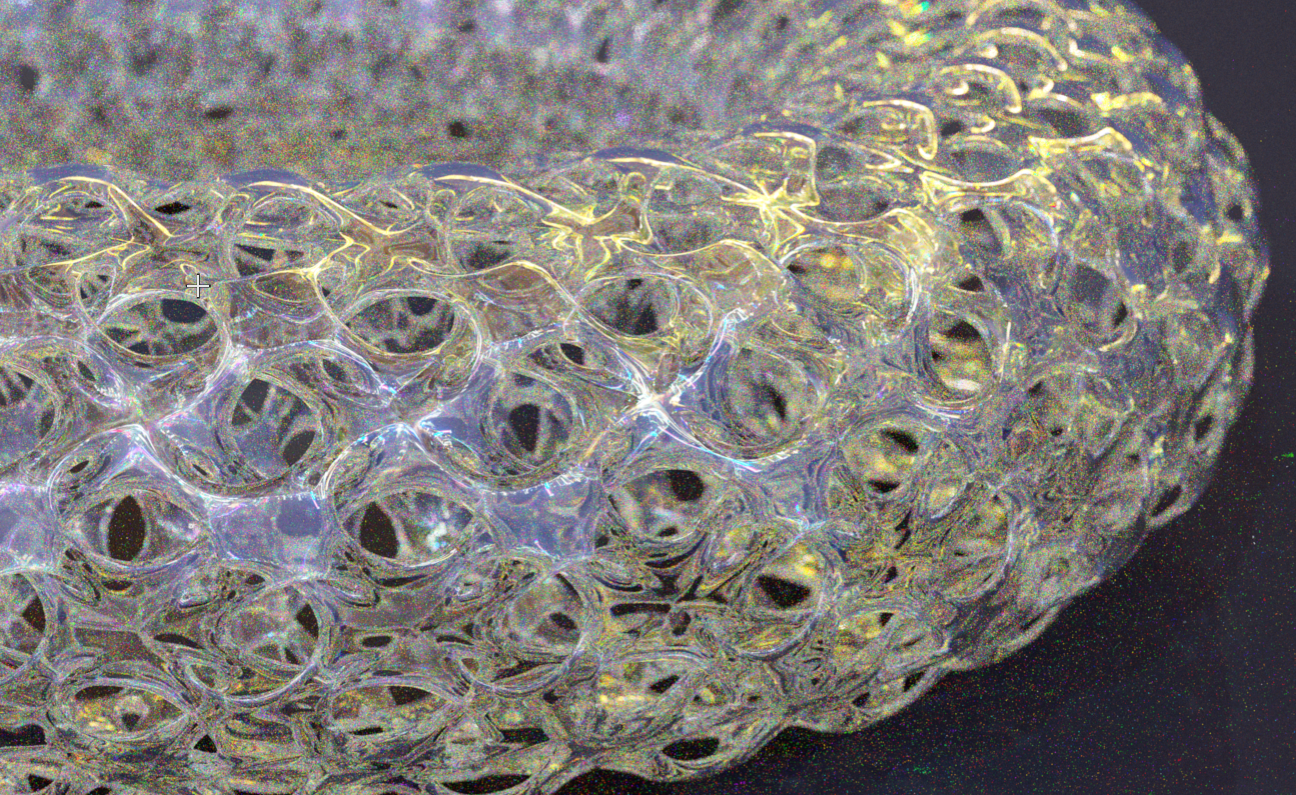

As can be seen in the image below there still is a lot of color noise present using Bidir + MLT.
Is Bidir MLT really the best render mode for this ?
Are there render settings that can be improved upon for such a scene ?
What SPP might be enough for a clean render ?
I submitted this to the Ranch Render farm and even 1000 SPP is not that much better.

Would have suggested blasting it in GPU mode, but you probably need a lot of path depth.
I'm not sure you need MLT for a scene like this, as there's no particularly hard caustics to solve due to the fairly flat lighting. Tried BiDir without MLT?
Re: Better render settings for this object/material
No, actually I was convinced that I needed MLT. But after 16 minutes of rendering in BDIR it looks promising. I've also given it 17 minutes in Path/GPU and that also does not look too bad.
It just takes a little patience to render this on a 2017 MacBook Pro
the thing about straight BiDir Pathtracing is it tends to keep clearing up progressively. MLT will show you the pretty caustics sooner, but the overall noise level does not decrease in such a linear way. I used to swear by MLT for everything, but Indigo's normal PT has gotten super fast.

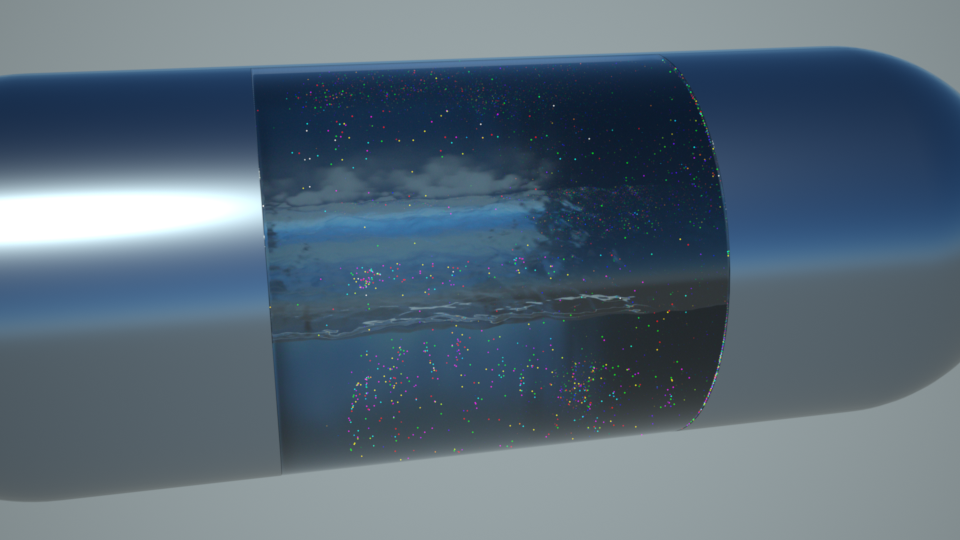

I dug out a super simple Indigo test scene I created many years back that I believe would be very difficult for path tracing.
The image below was rendered using bidirectional path tracing without MLT to 10000 SPP (on the Ranch Render farm). It is clearer but there still is a good bit of color noise visible.

10000 spp is a lot...
yeah, that's just a crazy complex image to resolve with so many reflections and refractions. I wonder if something like photon mapping would eventually help this out - I believe that was once in the works as an additional rendering option, it but I don't know what happened to it.

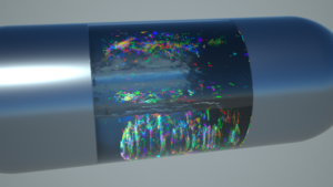

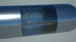

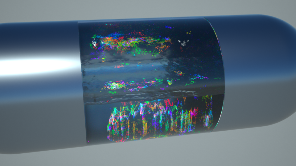

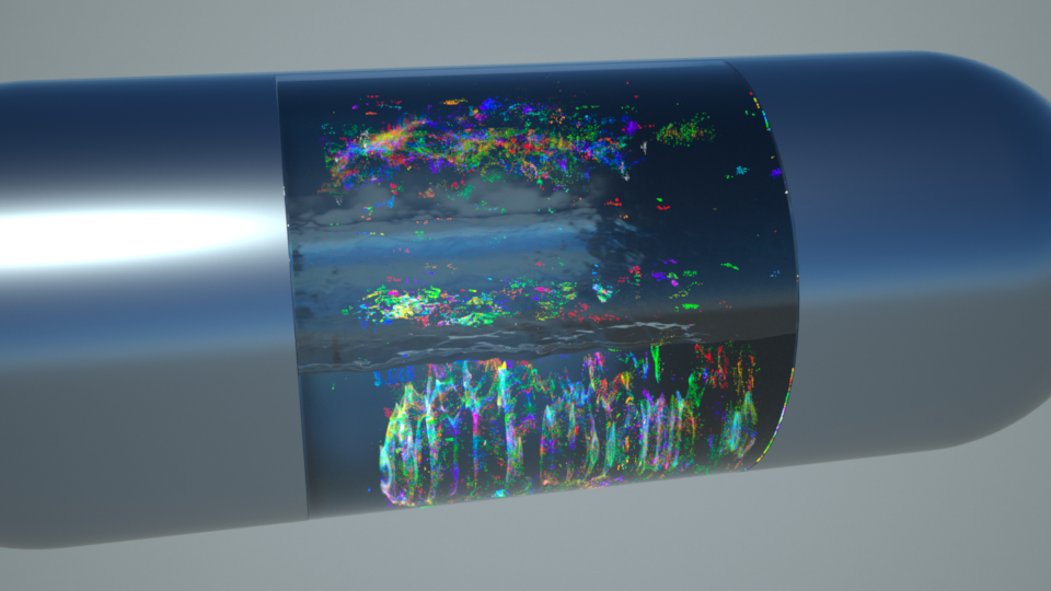

So here is a bt more food for thought. Below are 4 images of that old test scene. Its basically an Aluminum 'pill' with water in it and a glass window. the Glass is simple glass is a specular transparent material with IOPR of 1.5 and no Couchy B. The ware material is this from the online material DB https://www.indigorenderer.com/materials/materials/30
Th light source is the catured simulation sun.

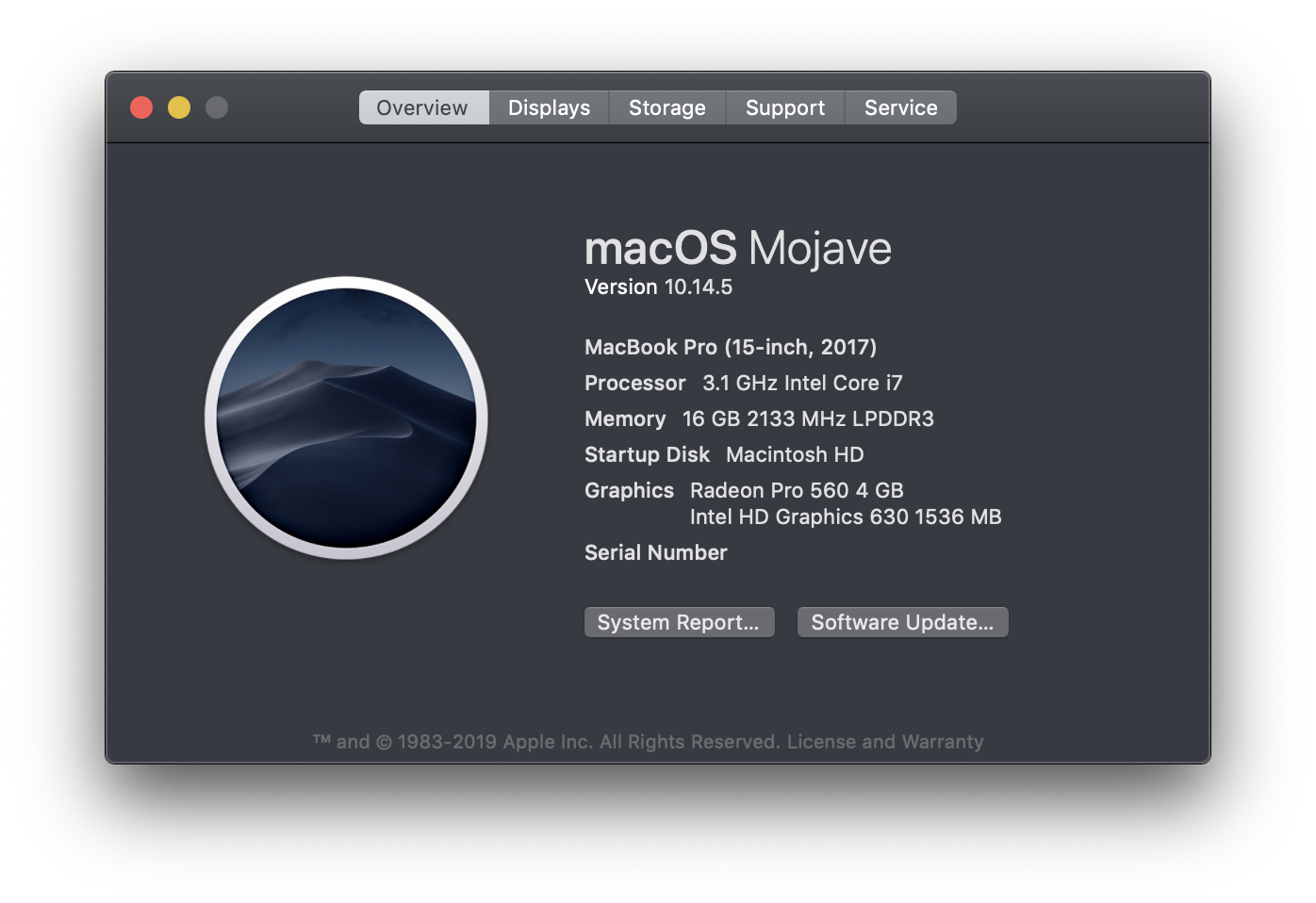

All of these images were rendered for 30 minutes on this machine;
The path tracing with MLT render appears to be the best solution for this scene and it clears faster than BIDIR with MLT. I suspect that BIDIR MLT is better when there are multiple small light sources involved (and caustic es, of course).
I need to verify that with another scene.
The BIDIR CPU render is almost completely bare of any caustics, but in the Path tracing with GPU render caustics slowly appear. It would be interesting to see how fast that clears on a real GPU.
