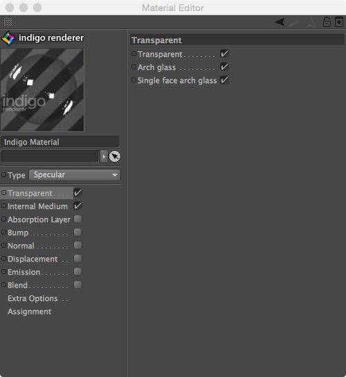

Do you have Arch Glass materials, or just normal glass? It is VERY important to use Arch Glass when you have big, flat windows where light should enter. I'm almost certain that this is the reason for simple BiDir performing worse.
Fix that and try BiDir again.

The tests involve intricate because different versions of Cinema and different versions dell'exporter.
Upgrading to all versions of the Cinema exporter latest and activating the option Arch Glass the results are correct.
I launched three rendering for the three versions of Cinema (R13 / R15 / R17) since the current deficit dell'exporter Mac is the limit of a single instanced time.
You were right, thank you!

Just a tip: single face arch glass is just supposed to be used when your glass doesn't have any thickness. Otherwise arch glass is a better choice.

Hey contegufo,
why don't you activate your C4D exporter version?!

Currently 3.8.26Zom-B wrote:Hey contegufo,
Before 3.6.24
