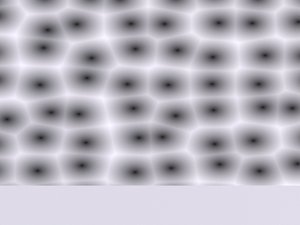

Here's a visualisation of the basic voronoi noise, with the code:
def scaledVoronoiDist(vec2 p, real scale) real :
  dist(p * scale, voronoi(p * scale, 1.0))
def eval(vec3 pos) vec3 :
  vec3(scaledVoronoiDist(getTexCoords(0), 10.0))
You can see the underlying grid pattern, which I will do some work to get rid of soon.

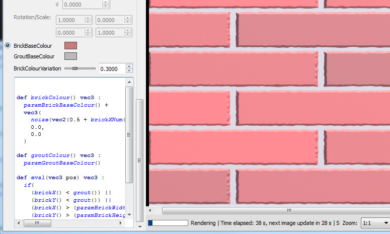

You will be able to define shader 'parameters' like so, which will then be available in your shader as pre-defined functions:
We're still working on the code, we'll make a fuss about it when it's done, because it should be pretty cool, and should finally make shaders easily tweakable by artists :)
	<albedo>
				<shader>
          <param>
            <colour3>
              <name>BrickBaseColour</name>
              <description>Base colour for the brick.</description>
              <value>0.6 0.2 0.2</value>
            </colour3>
          </param>
          <param>
            <colour3>
              <name>GroutBaseColour</name>
              <description>Base colour for the grouting.</description>
              <value>0.5 0.5 0.5</value>
            </colour3>
          </param>
          <param>
            <real>
              <name>BrickColourVariation</name>
              <description></description>
              <min>0</min>
              <max>1.0</max>
              <value>0.3</value>
            </real>
          </param>
					<shader>
						<![CDATA[
def brickColour() vec3 :
  paramBrickBaseColour() +
  vec3(
    noise(vec2(0.5 + brickXNum() * 10.0, 0.5 + brickYNum() * 10.0)) * paramBrickColourVariation(),
    0.0,
    0.0
def groutColour() vec3 :
  paramGroutBaseColour()
  if(
    (brickX() < grout()) ||
    (brickY() < grout()) ||
    (brickX() > (paramBrickWidth() - grout())) ||
    (brickY() > (paramBrickHeight() - grout()))
    groutColour(),
    brickColour()
					</shader>
				</shader>
			</albedo>
