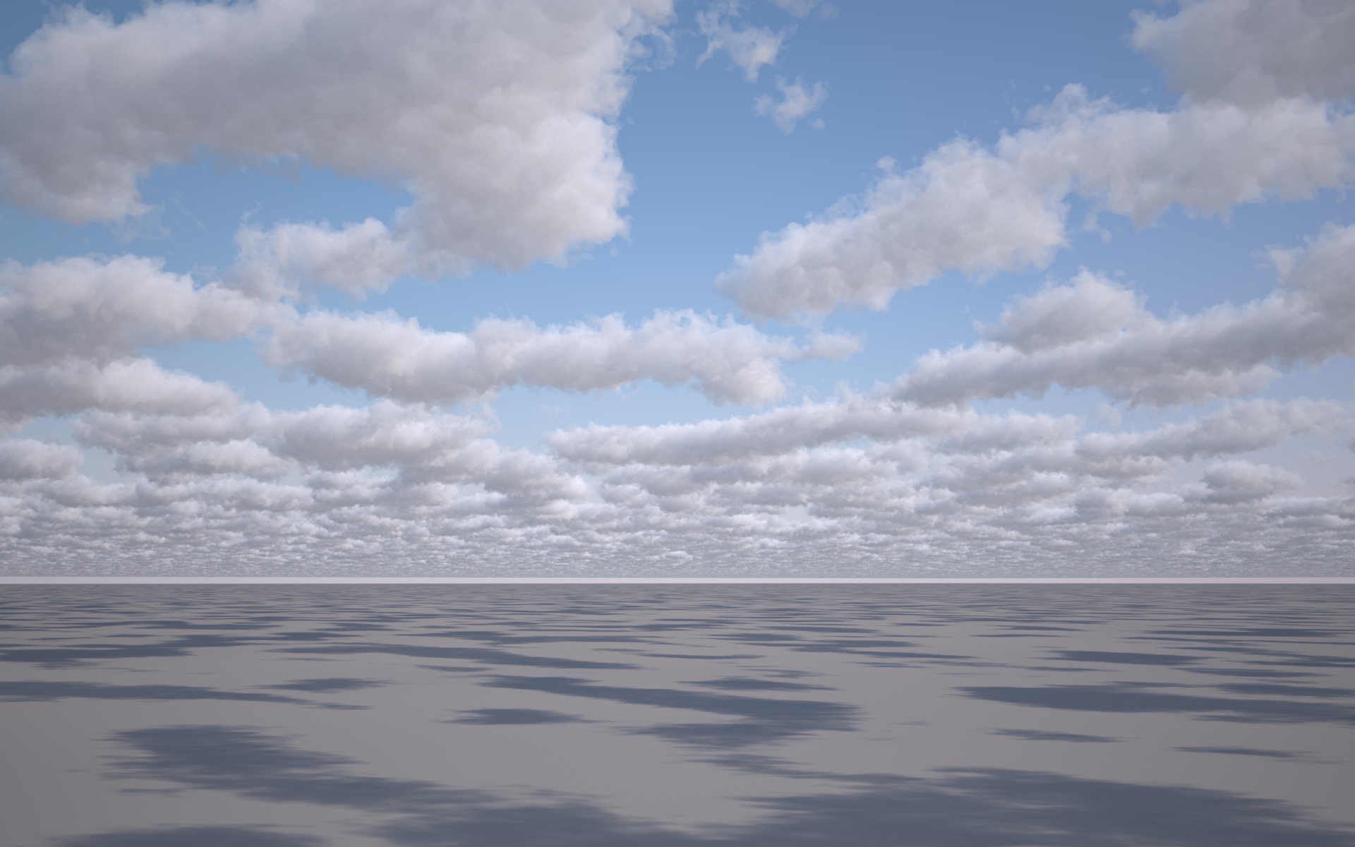

Post by OnoSendai » Thu Jan 02, 2014 4:16 am
Another cloud experiment:
Code for scattering coeff looks like this:
def z_envelope(real z) real :
                let
                  cloud_half_h = 100.0
                  cloud_h = cloud_half_h * 2.0
                  base_z = 1100.0 - cloud_half_h
                in
                  smoothPulse(base_z, base_z + cloud_h * 0.3, base_z + cloud_h * 0.5, base_z + cloud_h, z)
              def lowFreqBaseShape(vec3 pos) real :
                let
                  warped_pos = vec3(x(pos) * 0.6, y(pos), z(pos))
                in
                  (fbm(warped_pos*0.004, 8) * 0.5 + 0.5) * z_envelope(z(pos))
              def eval(vec3 pos) vec3:
                let
                  cam_pos = vec3(2077.0, -1447.410, 700.588)
                  A = 0.00001
                  octaves = max(1, floorToInt(-log(A * dist(cam_pos, pos))))
                  turb_offset = fbm3Valued(pos * 0.03, octaves)
                  c = lowFreqBaseShape(pos + turb_offset * 30.0)
                  max_sigma_s = 0.025
                in
                  vec3(step(0.6, c) * max_sigma_s)
The general principle is to use a low frequency FBM to define the general cloud shape. (lowFreqBaseShape())
I then use the 'turbulence' technique to add high frequency detail. This can be thought of as perturbing the domain of the function with a fractal vector field.
The final result is then 'windowed' with a envelope based on the height (I use smoothPulse for this), and then passed into a step function, which gives hard edges to the clouds.
One pretty cool technique I'm using here is level-of-detail (LOD) based FBM detail - the further away a cloud point is, the fewer octaves of noise are used. I'll write more about this in another forum post.

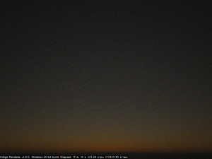

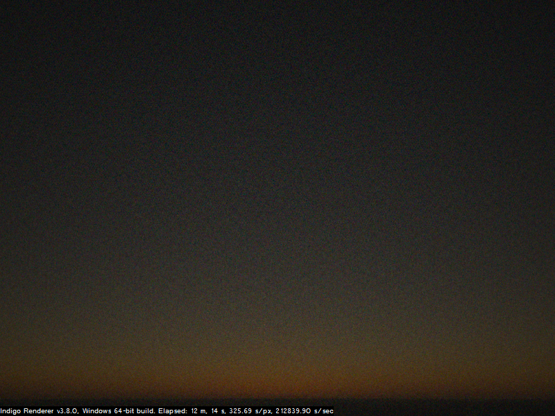

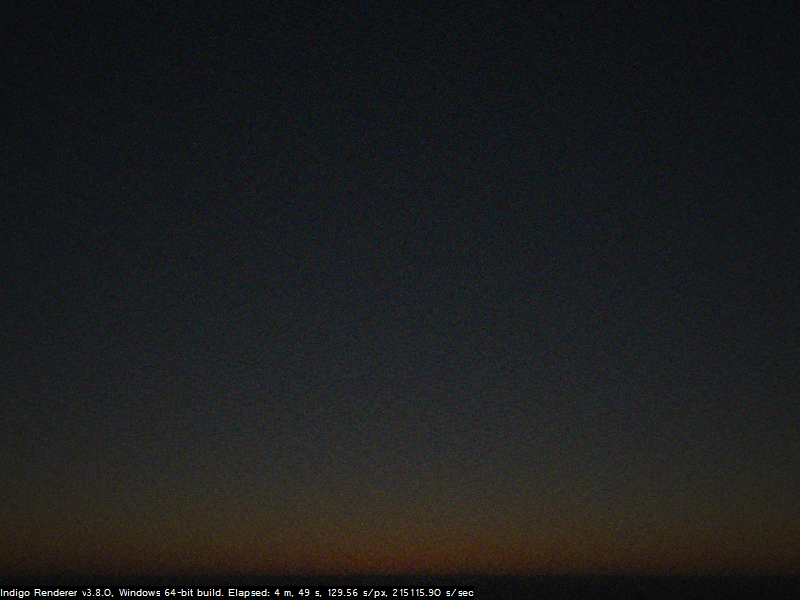

Added ozone absorption to the sky model.
It gives a nice blue colour to the sky especially with the sun is low in the sky, or when it is below the horizon.

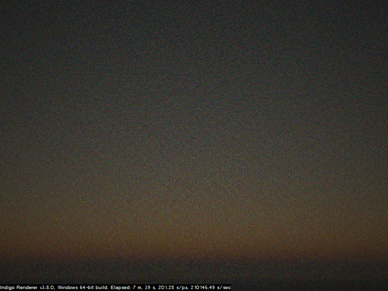

Re: Experiments..
Post by StompinTom » Sun Jan 05, 2014 3:35 am
That's looking good. Is this in the 'Original' sky model or the simulation model?
Re: Experiments..
Post by OnoSendai » Sun Jan 05, 2014 3:39 am
Hi Tom,
The ozone absorption has been added to the atmosphere medium. At some point I'll regenerate the captured simulation data so that the new sky model (captured simulation) will have the same effect.
Re: Experiments..

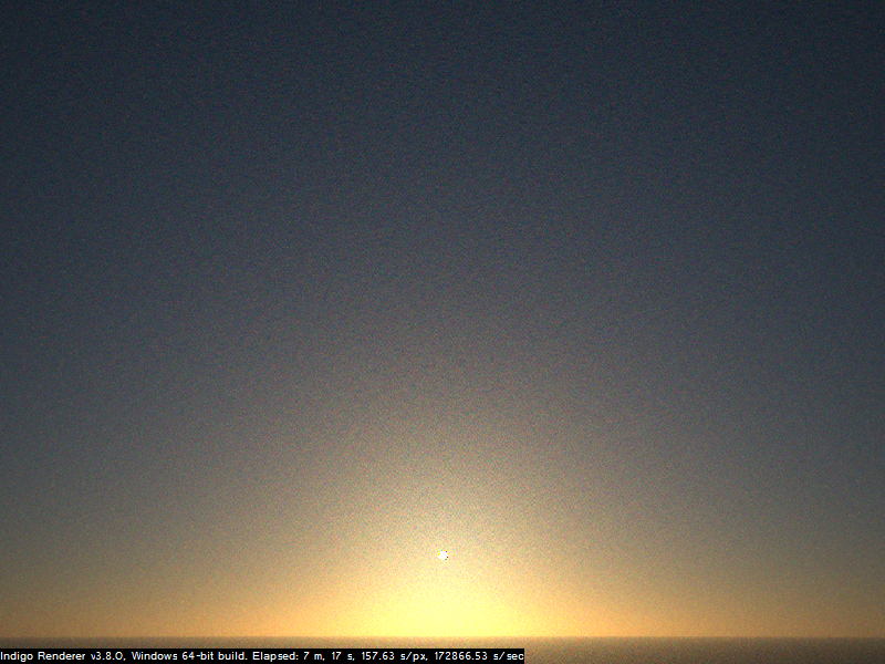

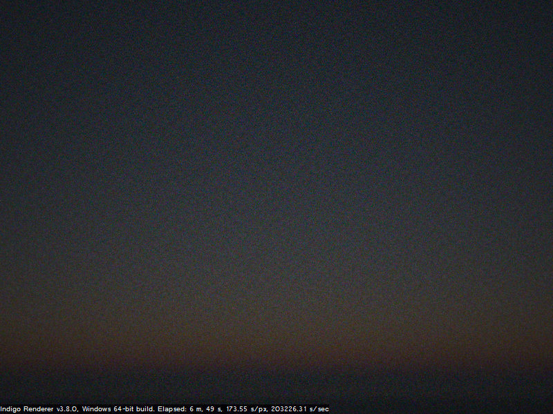

Post by OnoSendai » Sun Jan 05, 2014 3:52 am
In these renders the sun is directly behind the camera, 1 degree below the horizon.
Re: Experiments..
Post by Zom-B » Sun Jan 05, 2014 4:08 am
The slightly more blue tint looks better to me then the previous ozone-free version.
A subtle enhancement, but still very welcome ;)
