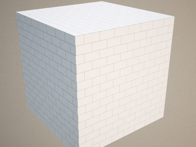

here is an image of my cmu block shader. im having scaling issues right now and cant get it to show on the matdb preview scene. but in any case, it is working. once the new shader functions are implemented the code can be optimized slightly.
cmu block shader
