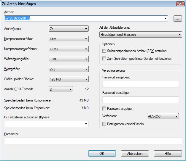

Post by Zom-B » Fri Apr 18, 2008 8:16 am
dougal2 wrote:nope.
15,800,239 im1188991340.7z
yeah ok, it's smaller than the others but it's still 91%.
I tested now on 3 different igi files from 14 to 102 MB, and I have to confirm my ~76%!
I have no idea if the content of an igi is related to compression size,
here are my 7zip settings using version 4.57 x64:
compressing a igi to ~76%
