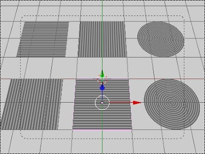

I read some posts where several people discussed anisotropic effect in this thread. Someone suggested a good way to fake it by using a bump map and I took a test with indigo 1.1.9.
The effect for anisotropy can be seen in the following image but it looks less realistic :(
The following image shows how the bump map was put on the planes.
It's all a fake, but the three parameters, IOR, Exponent, and B in Bump map in Blendigo 1.1.7, affect anisotropy well and you can change the looks easily :D. Getting IOR high will make the reflection bright, getting Exponent high will make the reflection thin, and getting B high will make anisotropic effect strong.
