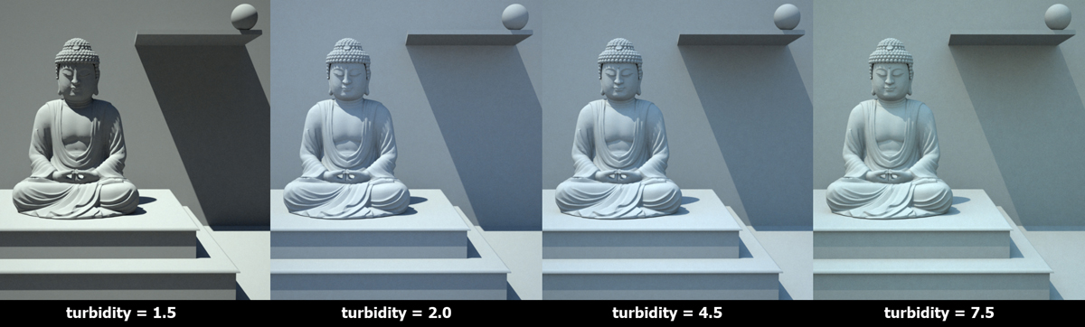

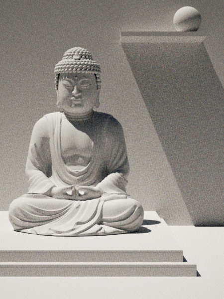

Sorry guys, I was just testing again the turbidity parameter for I'm writing a small tutorial about lighting for the Indigo italian forum. I just experienced something I was not expecting, indeed.
I was sure that low turbidity parameters would actually lead to more blue images, and high values to more yellow-orange images.
So I did two tests and these are the results: the value of 2 gives more blueish tones than 1.5, which confuses me a little. :roll:
I have to say that the render with turbidity=2 was done with the 2.2.6 version, while the render with turbidity=1.5 was done with the 2.2.7 version.
So I ask you all: is that all correct? Is this some kind of bug? I was wrong assuming that 1.5 would have led to a more blue-tinted image?
Thank you for your anwers!
Done with Indigo 2.2.7
Done with Indigo 2.2.6

Post by Pibuz » Sat Nov 14, 2009 5:36 am
Here are some other comparisons. I find that the turbidity parameter has been somehow heavily corrupted by other lines of the code. The maximum turbidity leads to a slightly coloured image, while in the past would have meant a really orange overall tone. I guess this is a bug.
turbidity test.jpg (416.05 KiB) Viewed 11487 times

I'm now asking for help here: is anyone still using a previous version of Indigo? Better: SkIndigo?
I'd ask if it could be possible to do four tests with the turbidity values I've set for my latest test, and post the result, a detailed model is not needed: a cuve with a plane in the background will do the job. I think the overall atmosphere will come out quite different, using version 2.2.6 or previous.

Pibuz wrote:... is anyone still using a previous version of Indigo? Better: SkIndigo?
Hi Pibuz and all, I'm using Indigo 2.2.1 and SkIndigo 2.2.3.
I've done four test with your turbidity values, White Point set to E
here's the result
turbidity test_mj.jpg (248.37 KiB) Viewed 11296 times
Re: Turbidity
Post by OnoSendai » Sun Nov 15, 2009 11:01 am
IIRC, turbidity should always be set in the range 2 to 6, due to limitations of the original model.
Re: Turbidity
Post by Pibuz » Sun Nov 15, 2009 9:51 pm
OnoSendai wrote:turbidity should always be set in the range 2 to 6, due to limitations of the original model.
That's something Whaat has to fix in SkIndigo then :wink:
OR you have to increase the range Ono :lol: BTW this is a silly thing, I know..
mr_jo:
Thank you very much for your tests. really informative.
Now, for a proper comparison I'd say we have to test again with "accepted" values.
can you do some tests with Turbidity equal to 2 - 4.5 - 6?
I'll do the same with 2.2.7 version. Thank you a lot!

Re: Turbidity
Post by mr_jo » Mon Nov 16, 2009 8:44 am
Hi Pibuz, here's the result
P.S. I've changed a little bit the gray from the previous test
turbidity test_bis_mj.jpg (289.5 KiB) Viewed 11060 times
