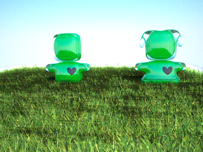

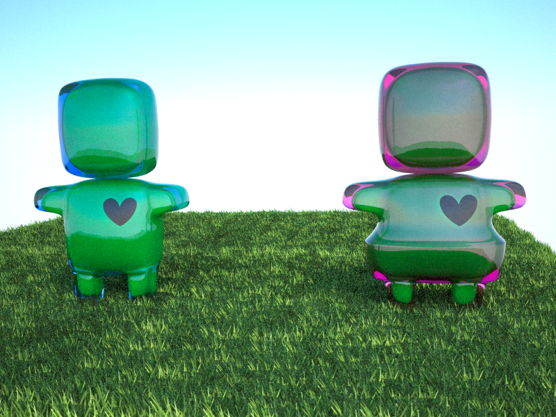

hi again! after a loooong time of vacations from the 3d world, i come back again to make a simple scene for a gurl, well, my problem is that i'm creating grass with drBouvierLeduc's technique, but i got an issue when im doing it, there appears some sort of "shade" on the alpha plane, (which is supposed to be invisible), the material is a blended one, blending a material with the image of the grass as albedo texture, and another material as "null", then i set the alpha map as the alpha-grass-image... i dont know what's wrong, besides i already checked that problem on the thread where i found the tutorial, and somebody says that i had to turn off the biDir button, well, it was already off, then i turned it on, to see what happened, and suprisingly the images became better, but still with artifacts... i attach the images so you can see the actual problem and you can give me an advice.... btw im using Indigo0.8 jejejejeje
biDir on, you can see the "dark lines" above the grass
bidir turned off, there are the dark lines and also there is some sort of white "aura", surrounding the bounds of my grass...

Post by Kram1032 » Sun Nov 02, 2008 12:36 pm
0.8 is MORE than out of date, as I stated somewhere else, already...
Post by Borgleader » Sun Nov 02, 2008 1:06 pm
Kram1032 wrote:0.8 is MORE than out of date, as I stated somewhere else, already...
1.0.9 is latest "stable" isnt it?
Post by PureSpider » Sun Nov 02, 2008 11:23 pm
It is... USE THAT (atleast)!
Post by CTZn » Sun Nov 02, 2008 11:47 pm
http://www.indigorenderer.com/joomla//f ... 3560#63560
As a reference. So if you still have problems with 1.0.9 and null+bidir, try the latest version.
