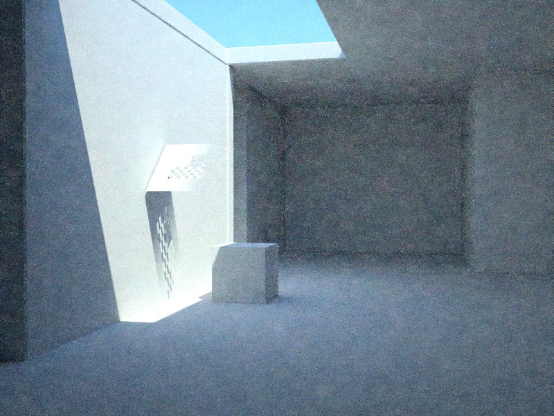

Hi,
I'm testing the way to use "alpha maps".
I have blended a white diffuse material with a null material.
The shadow looks good, but the null material is rendered as a gray material.
the code:
	<material>
		<name>null</name>
		<null_material/>
	</material>
	<material>
		<name>Material.001</name>
		<diffuse>
			<albedo_spectrum>
				<rgb>
					<rgb>0.8 0.8 0.8</rgb>
					<gamma>2.2</gamma>
				</rgb></albedo_spectrum>
		</diffuse>
	</material>
	<material>
		<name>Material</name>
		<blend>
			<a_name>Material.001</a_name>
			<b_name>null</b_name>
			<blend_factor>1</blend_factor>
			<blend_map>
				<path>masktest01.png</path>
				<uv_set>uv</uv_set>
				<exponent>1.000000</exponent>
				<a>0</a>
				<b>1</b>
				<c>0</c>
			</blend_map>
		</blend>
	</material>
tested it with following code, too:
	<material>
		<blend>
			<blend_factor>uv</blend_factor>
			<blend_map>
				<uv_set>uv</uv_set>
				<a>0</a>
				<b>1</b>
				<c>0</c>
			</blend_map>
		</blend>
	</material>
(with "<blend_factor>uv</blend_factor>")
(indigo 1.0.3)
Diffuse blended to null material
Post by CTZn » Mon Nov 19, 2007 3:39 am
That may be because bidir is on, AFAIK null material doesn't like that.
Posts: 6243
Post by OnoSendai » Mon Nov 19, 2007 3:43 am
Looks alright to me, where's the problem?

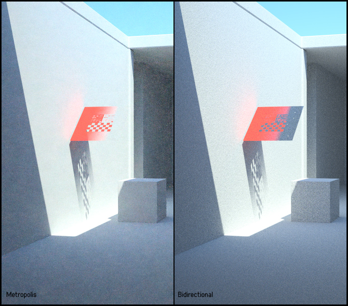

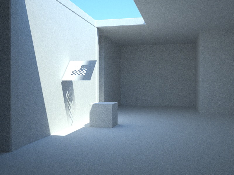

EDIT: Null material is not transparent with bidir on. Try your grass tutorial with bidir on.
CTZn was right. The problem was the bidir. (Thanks for your help)
I have rendered it now with Metropolis only and it's looks ok.
Here's the Metropolis render:
Metropolis don't have the problem.

Post by Conz » Mon Nov 19, 2007 4:36 am
Some clear rendering. The diffuse material is now red.
Post by CTZn » Mon Nov 19, 2007 6:26 am
I spent some time myself checking the image b4 posting, but I did when I identified that the gray region on plane could not be a shadow projection.
That's a known issue Conz,
cheers !

Post by Conz » Mon Nov 19, 2007 6:33 am
CTZn wrote:...
ok, thank you.
Yes I agree, the first sample picture was not clear enought.
