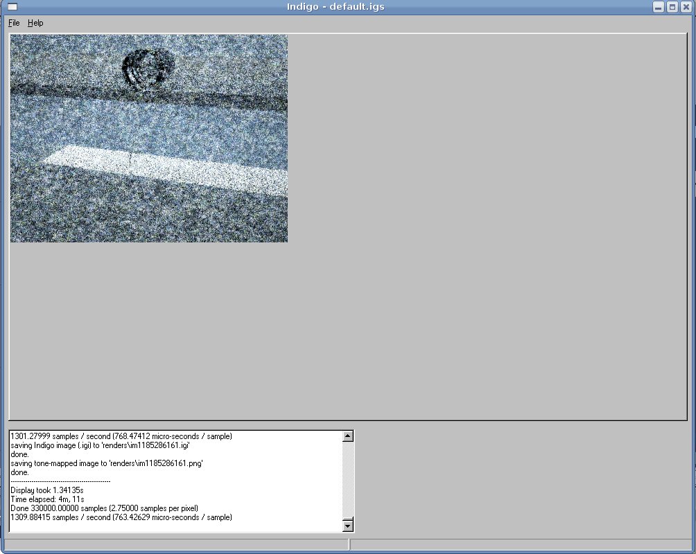

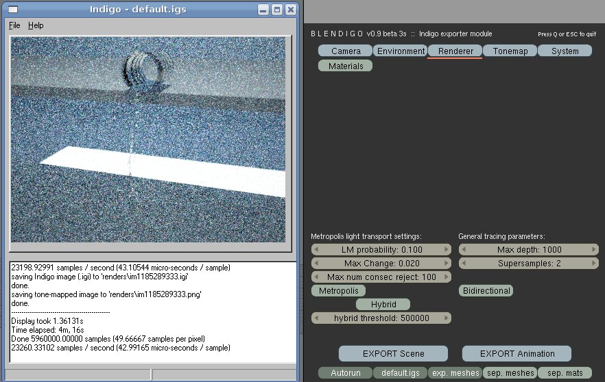

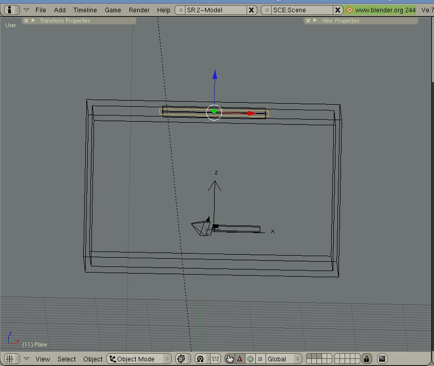

I have a room with a hole in the ceiling. The only lightsource is a sun. With exit-portal it is much slower than without.
I use blendigo, indigo_09_test3. The exit-portal is a plane (4 verticles) facing inwards.
Any ideas?
with exit portal

exit-portal setup
Post by OnoSendai » Wed Jul 25, 2007 2:34 am
try setting bidir = true
hybrid = false

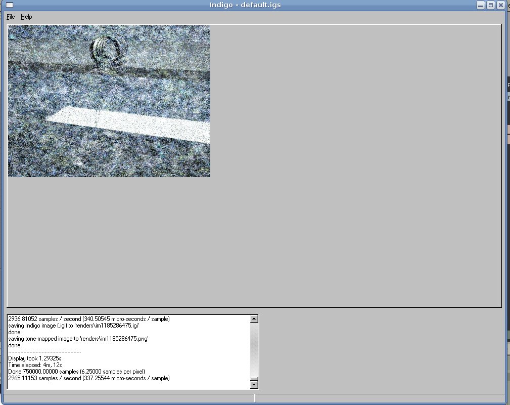

Post by Macrob » Wed Jul 25, 2007 3:23 am
Hmm, the fastest (in micro-seconds/sample) is all off, no exit portal.
"all off"
Post by OnoSendai » Wed Jul 25, 2007 4:06 am
The rate of reduction in noise is the important thing, not samples per second.
zsouthboy
Posts: 1395
Post by zsouthboy » Wed Jul 25, 2007 7:27 am
Yeah, you could be getting more samples per second, but they're being used on portions of the scene your camera can't see.
