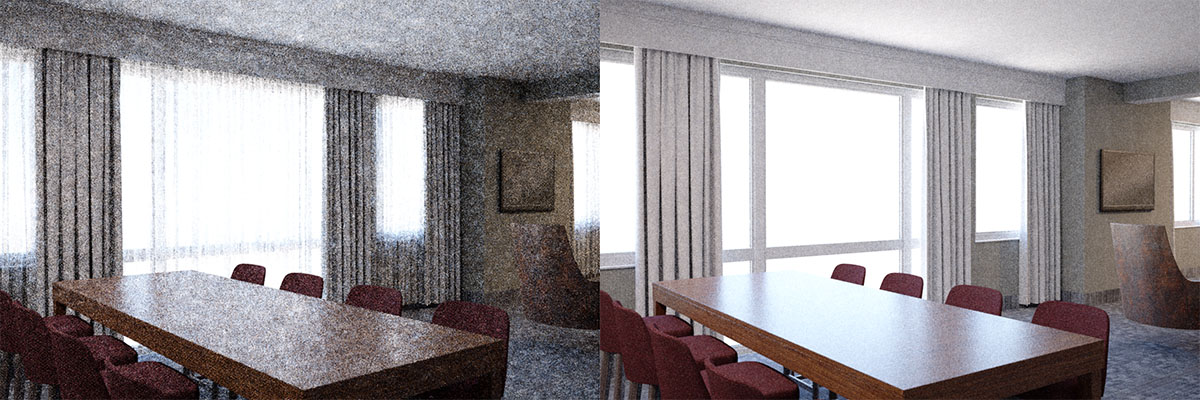

Post by SreckoM » Tue Jan 12, 2016 12:34 pm
This is comparison between with curtains and without. Same time, around 2min. Mlt Bdir. Much nosier.
Compare
Re: Curtain and noisy renders
Post by Zom-B » Tue Jan 12, 2016 7:46 pm
SreckoM wrote:This is comparison between with curtains and without. Same time, around 2min. Mlt Bdir. Much nosier.
Since all the light needs to pass your curtains, its quite some extra calculations Indigo needs to do, that snot for free!
for more transparency don't blend with a null, that should slow everything down a lot. Instead use a black + white checkerboard texture set it to step blend and scale the tiling on the curtain down a lot! By that light rays will either hit a full block or full pass in the curtain. this should result in better rendertimes (less fireflies).
For this approach you can reduce DT or even leave it fully away.
The hard part here is to fine-tune transparency further, here for you need to alter the chekerboard mask with bigger black areas, or white for more transparency...
Better use BiDirPT for interiors, and if you really need to use MLT, then raise the "Larg mutation Prob." to 0.85 for more PT like noise behaviour...
For your sunless setup it could be also interesting to set the EPs in your windows to emitters, that emit uniform light, this should speed up calculations too :)
