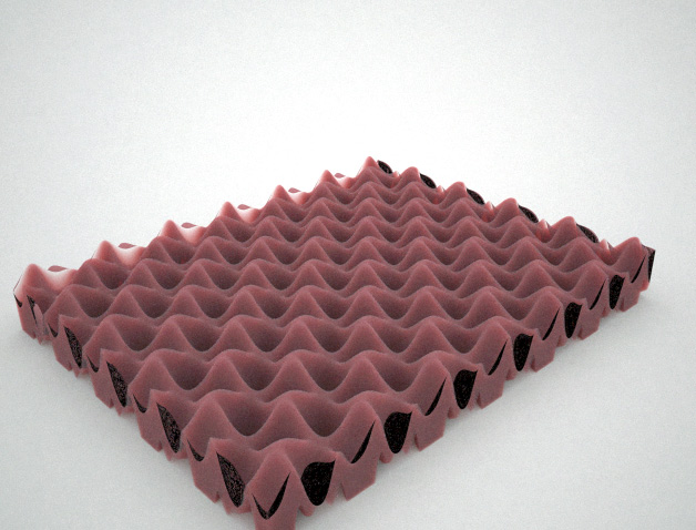

here's a pic I made experimenting with SSS. It's that pink egg carton type foam that you sometimes see in packing. I know, it needs to be brighter..
Also, ignore the smoothing issues :) (the black spots)
-niko

Post by nikolatesla20 » Sun Mar 11, 2007 1:59 am
well for the foam:
Specular material
Absorption absorb everything but pink. set gain higher, like 15 or 20.
IOR 1.0
subsurface scattering turned on, set to uniform, with value of around 3 or 4. If it starts looking too transparent, then set the value a little higher, but not too high.
For the monkey wax:
specular material
absorb all but green, gain up around 20 I think, maybe higher
IOR 1.1
subsurface scattering turned on, uniform, set value to 2.0.
I used a HDRI probe to make it look more real. (an .exr environment map)
I don't have screenshots since these were tests, but I do remember most of the settings were not extreme.
-niko

Post by Kram1032 » Tue Mar 13, 2007 2:01 am
very nice mats!
2 things:
I *think* IOR should be higher for Wax, therefor lower exponent, as you nearly can't see any reflections, normally.
Then: Maye the "value" should be higher, or the precedece, or something: The ear is much too transparent. At least @ standard, suzanne should have ears that are ~ 5cm thick -> way isn't transparent at this thickness.
I slightly can figure out, what's behind it, if it's white wax and just 5mm thick!
Also, test if you even can absorb a bit of the green things... this may give better results... ;)
