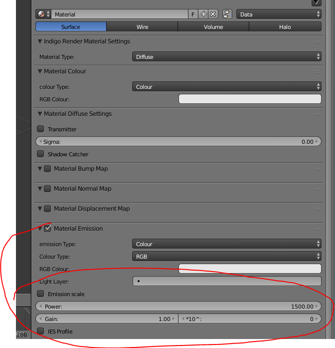

yeah, it's in the material properties if you make a normal emitting material in Blender, but specifically talking about using an external emitting material, you lose the option of specifying the emission scale. the issue is the difference between how Blendigo defines emission scale (through the material properties) and Indigo (through the object properties). I think that creates a stumbling block in a situation like what Headroom is trying to do.

Yea, I know that and that works fine if I define a Light source with a Material Type: Diffuse for example I can then make a check mark by Material Emission and also a check mark in Emission scale.
Then using RGB or blackbody or Uniform.
RGB is how I've always defined the LEDs in the render linked to in the first page.

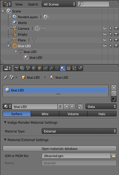

However, if I use a tabulated spectrum I can only do that with an external material such as the "blue LED". In that case Blendigo does not present me with an option to define the emission scale.
Now if there is a way to do this by editing the .igm I'd be all ears

I think I have figured part of it out.
The first observation: This cannot be achieved through the Blender exporter. The .igm file has to be edited using a text editor and then loaded as an external material into Blender eliminating the ability to change the emission scale in Blender. At least now it can be changed using a text editor.
basically there are two "slots" that are available to define an emitter:
and
The emission scale will have to go into the [base_emission] and the tabbed values go into the [emission]
That material can easily be loaded into Indigo and the emission value scaled in the uniform tab. It's a little misleading that the slider only allows values of up to 10 indicating this as a maximum but manually values of up to 1,000,000.0 can be inserted into the field.

I have to correct my statement!
Indigo does export emission scale properly. Unfortunately it is an object property and not a material property. A fact that the Blendigo interface hides from the user. While I understand the design decision behind it, in this case it has the disadvantage that I now not only have to manually create an .IGM file for the tabulated spectrum, but I also have to manually edit the emission scale parameters in the exported objects.igs file.
As opposed to the scene.igs file the objects .igs file does not use end of line characters, which makes manual editing a major PITA and of course this edit is lost after the next export.
