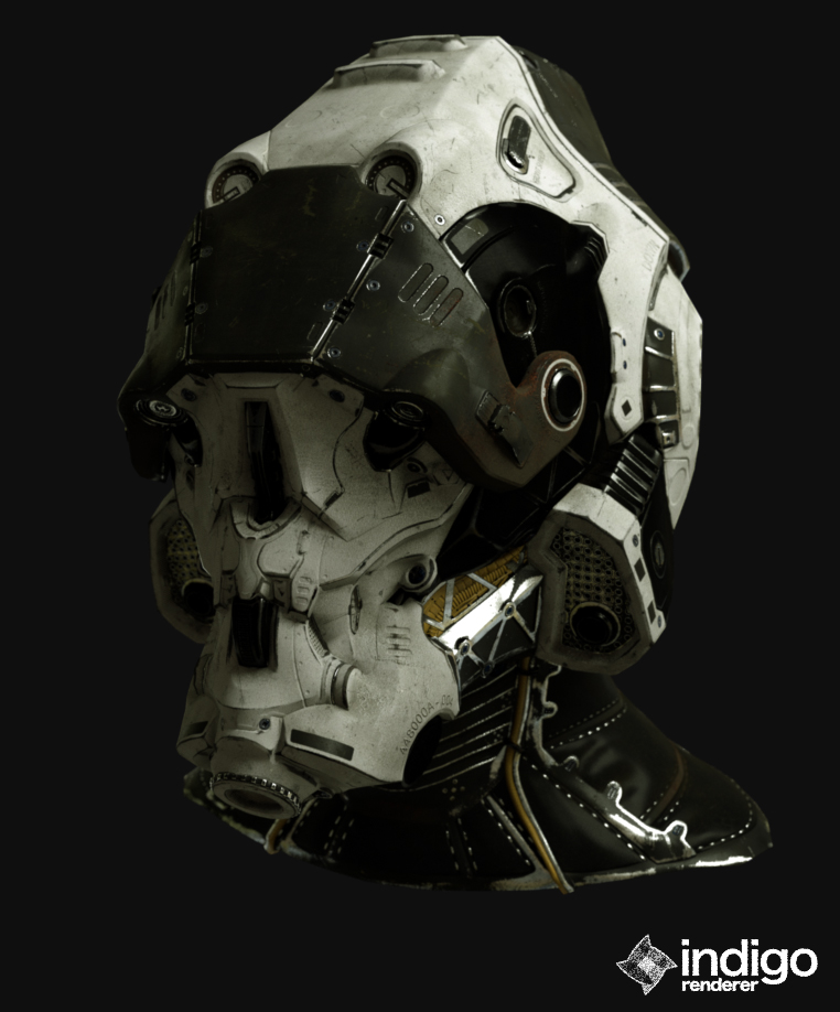

Post by aleksandera » Thu Jun 19, 2014 11:31 am
I have also made a quick test (hope you don't mind for posting it here).
Although I don't have the same lightning. Where is the hdri? Probably in the software?
Must say a great model and textures from Michael Pavlovic :shock:
