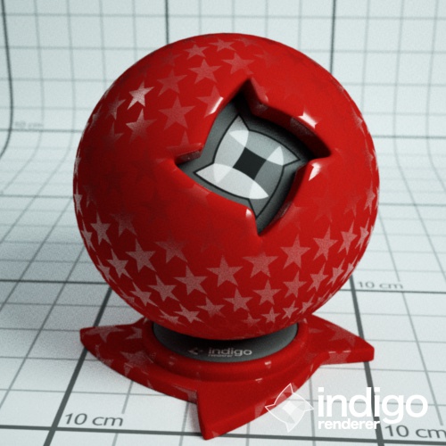

Post by FakeShamus » Fri Jan 11, 2013 3:28 am
noldo wrote: In the fresnel scale channel (with a bitmap applied, for example a black & white checkerboard), the black value mean NO reflection (someone like lambertian material), the white value mean normal reflection value (1.0) in according with the glossiness in the exponent map.
this is possible, are you using the newest version, 3.6.4?
