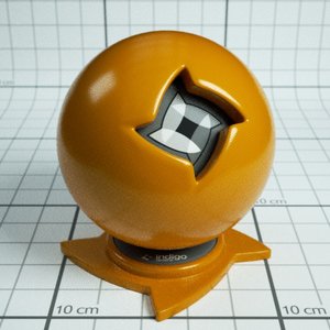

Post by CTZn » Fri Dec 07, 2012 8:37 am
galinette wrote:
CTZn wrote:Thanks Tom !
The next one can get real creepy sometimes... noise fun.
Some physicist comment:
It's too visible that you only use the normal for computing the thickness. This leads to some undesirable effects:
- The sharp angles show a sharp change in thickness
- The top flat part of the base has virtually nothing on it, while it should be one of the thickest (it's at the bottom, plus it's lying flat so the liquid should not flow from it
Some more advanced shader could make use of the altitude as well as the normal. [...]
Sorry for criticizing, that's looking very good (and scary :? )
Cheers,
Etienne
It's clealy an artistical approximation, vehiculating the idea that some fluid that was around ended below eventually.
I did not even test the material on a different mesh, it was really made against a sphere and is expected to work best on closed, smooth shapes. The use of 2*Pi in the power illustrates that over-adaptation of the shader to the one mesh. Again, I just eyeballed that 2*Pi couldn't be wrong against a spherical thing, period :lol:
Now, it belongs to me to discriminate between what is a positive criticism and what's not. I'm litterally hungry for the former. You'll never profess the other kind without me telling you, and irritably enough I can defend myself :twisted:
Everyone here should know that my authority is all symbolical (it's a badge) and that I'm sad that many don't dare to criticize up to my doings. Mark my words and thank you again !

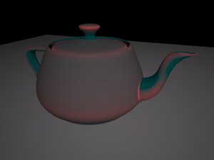

Post by OnoSendai » Fri Dec 07, 2012 11:16 am
Gaussian curvature:
Red = positive curvature, green = negative curvature.

Post by OnoSendai » Fri Dec 07, 2012 11:36 am
A test with the coating thickness based on Gaussian curvature.
It kind of works in this case, however I don't think Gaussian curvature is the right curvature metric to use for this kind of thing, because a crease in a flat surface will have zero Gaussian curvature.
galinette
Posts: 923
Location: Nantes, France
Re: Coating material tests
Post by galinette » Fri Dec 07, 2012 12:30 pm
OnoSendai wrote:A test with the coating thickness based on Gaussian curvature.
Yes, we need the sum of curvatures and not the product
