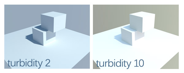

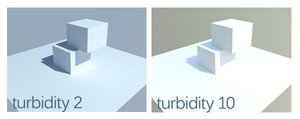

Increase turbidity and then change the white point to something more blue, because increasing turbidity will make Sun/Sky color warmer.
Re: How to reduce sun intensity of Sun & Sky Light in Indigo

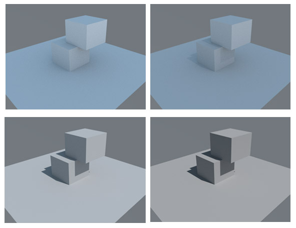

Unfortunately turbidity don't work for me. I show a litle example:
Turbidity, even extremly high affects sky color and slightly soften shadows.
But what I want is to tune strength of sun from completly off. I attach example from yafaray.
On first image thers no sun component (only sky ambient ). Second image: 90% sky, 10% sun. Last: 50/50.
I need something like in LuxRender where exporter give me the ability to set gain for both: sky and sun component

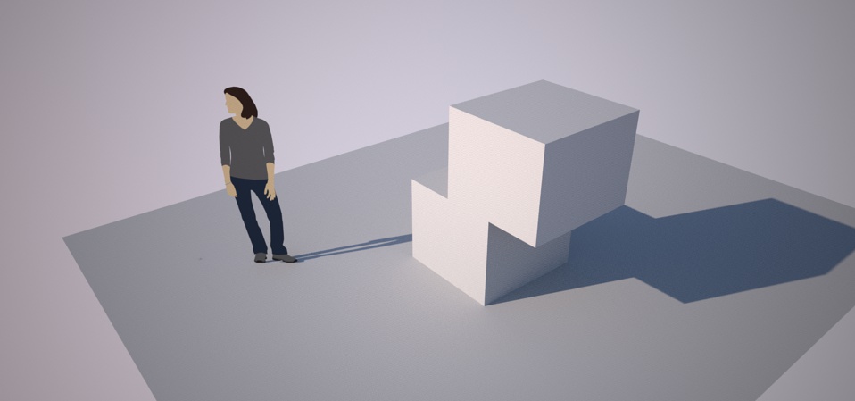

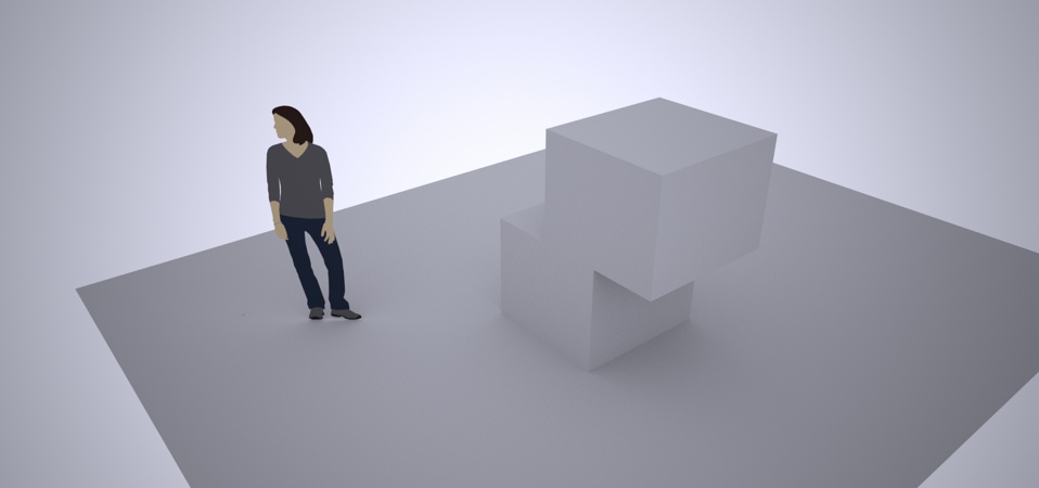

If you're using sketchup you could try this:
1) In Indigo settings set environment from Sun & Sky to Sketchup background (leave 'black' unticked)
2) In sketchup styles, change the model background to a dull grey colour
Not ideal I know, but works to an extent. Images below
Alternatively, do the above but tick 'black' for sketchup background in render settings and then have a massive object somewhere off camera as an emitter to act as your sun which you can set the power of? A bit bodgy, but might work with some trial and error.
Thank You for advice. I tried with env maps and emiters. Yes it work's but is slower and give more noisy renders.
