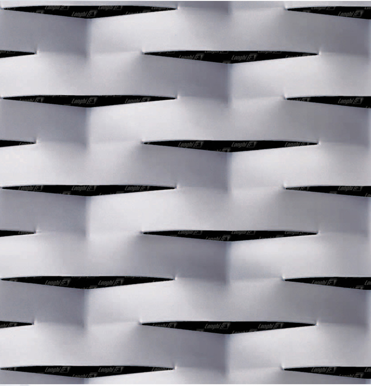

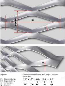

Hi guys!
Need a little help here..
I'm trying to model this, but it seems it's too hard for me to get it right, using sketchup..

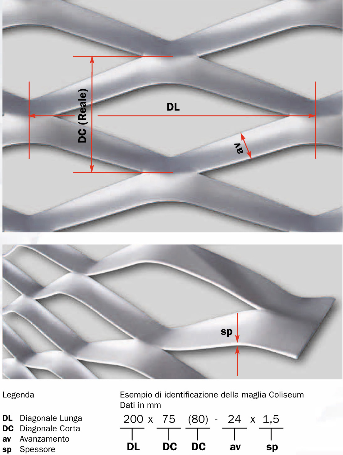

It's a stretched metal sheet, I'm attaching the technical reference..
Can anybody give me a hand with this? I'm trying to get a tileable model, which I can reply over the portions of facade I have to cover... I don't need it to have a thickness, but it must be a 3D model (not displaced textures..)
Thank you a lot guys..

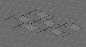

Peter Guthrie posted a couple of textures he made to get exactly this material: http://www.peterguthrie.net/blog/2010/0 ... ded-metal/
There's also an explanation of how he generated it, including a screenshot of the model he made.

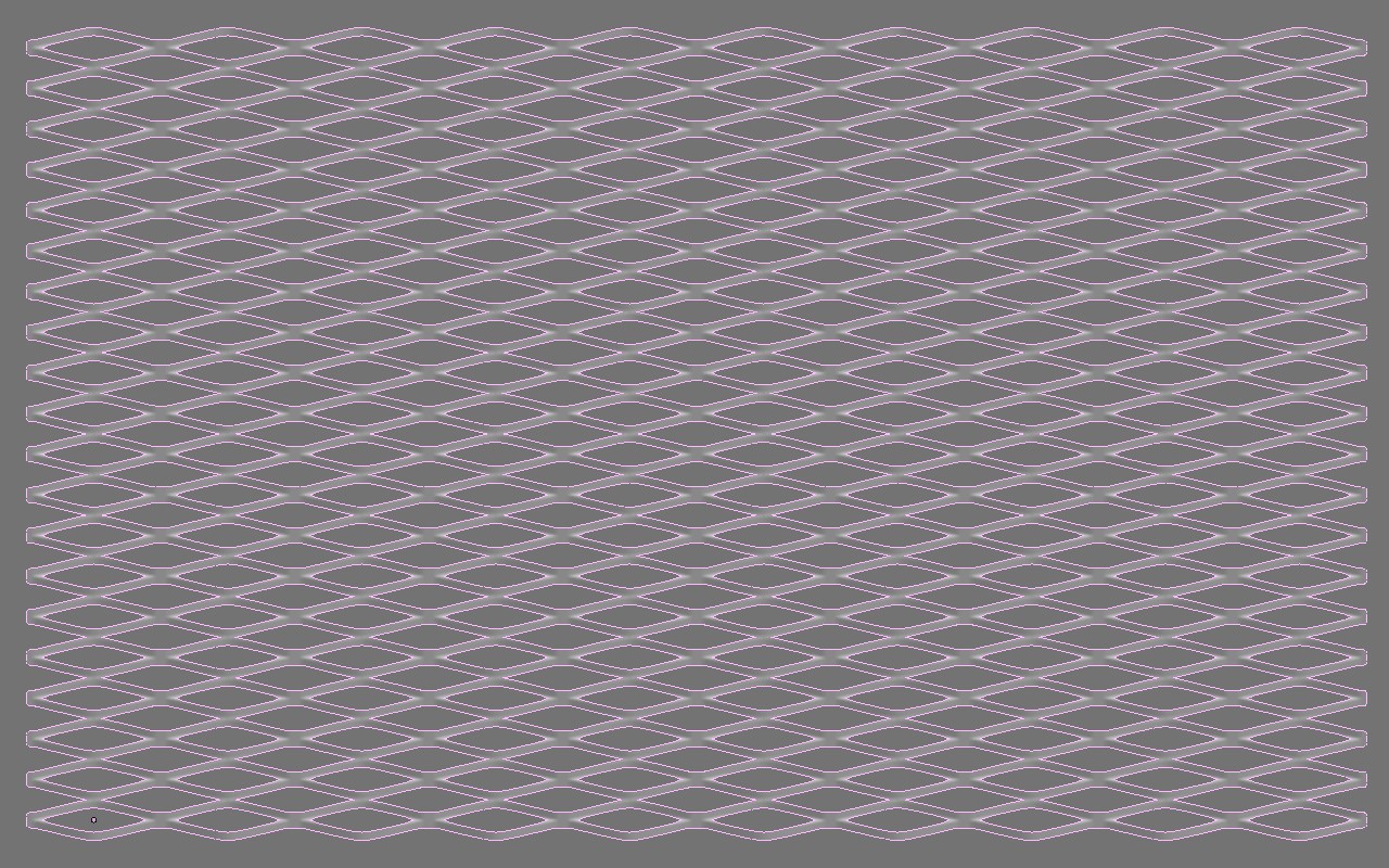

Basically, since it's an expanded sheet of metal, it's made by cutting little lines into a flat sheet, which is then pulled apart. Below is a little demo I made in Blender very quickly. The thing is you have to then rotate the object so the whole thing lies flat because you end up making a bunch of little 'steps'.

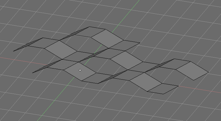

ah, I'm late !
Here's my attempt, not perfect but basic enough to allow you to tweak it. I changed the file extension for upload.
PS: units are centimeters.

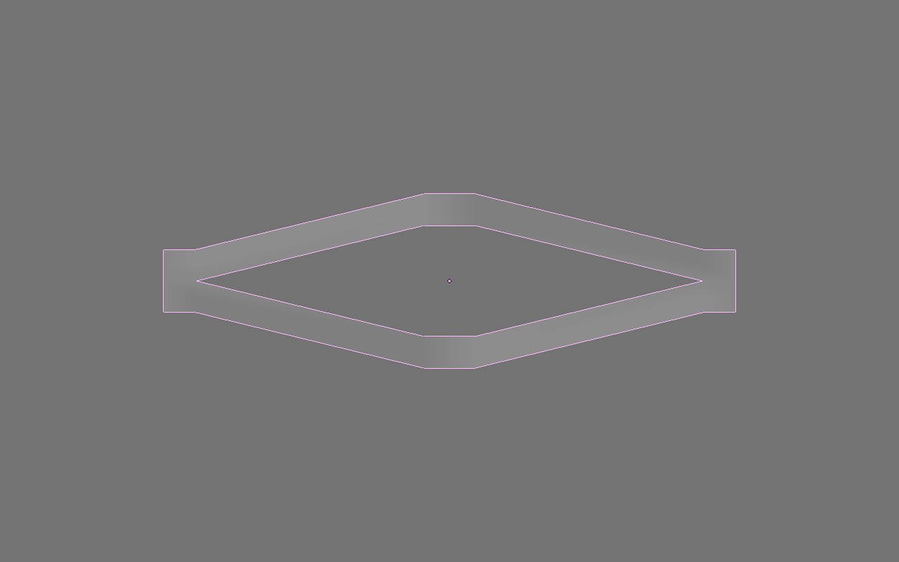

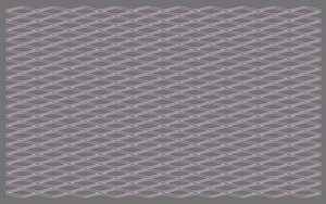

Hey,
here are two .OBJects — one of them is the part for the arrays, without subsurf and arrays modifiers and the second one is the 10x20 net with subsurf and array modifiers applied.

Hi, Pibuz, did you try the model I've posted? From you definition it might work for you.
Re: [REQ] Help me modeling this
Hi dakiru. I had some timing problems yesterday, but I gave your model a look last night: seems to work almost good. I have the feeling that the holes are a little too stretched, but it is something I can fix (I think) ... OR ... I'll leave them like they are now and pretend they're actually like that
