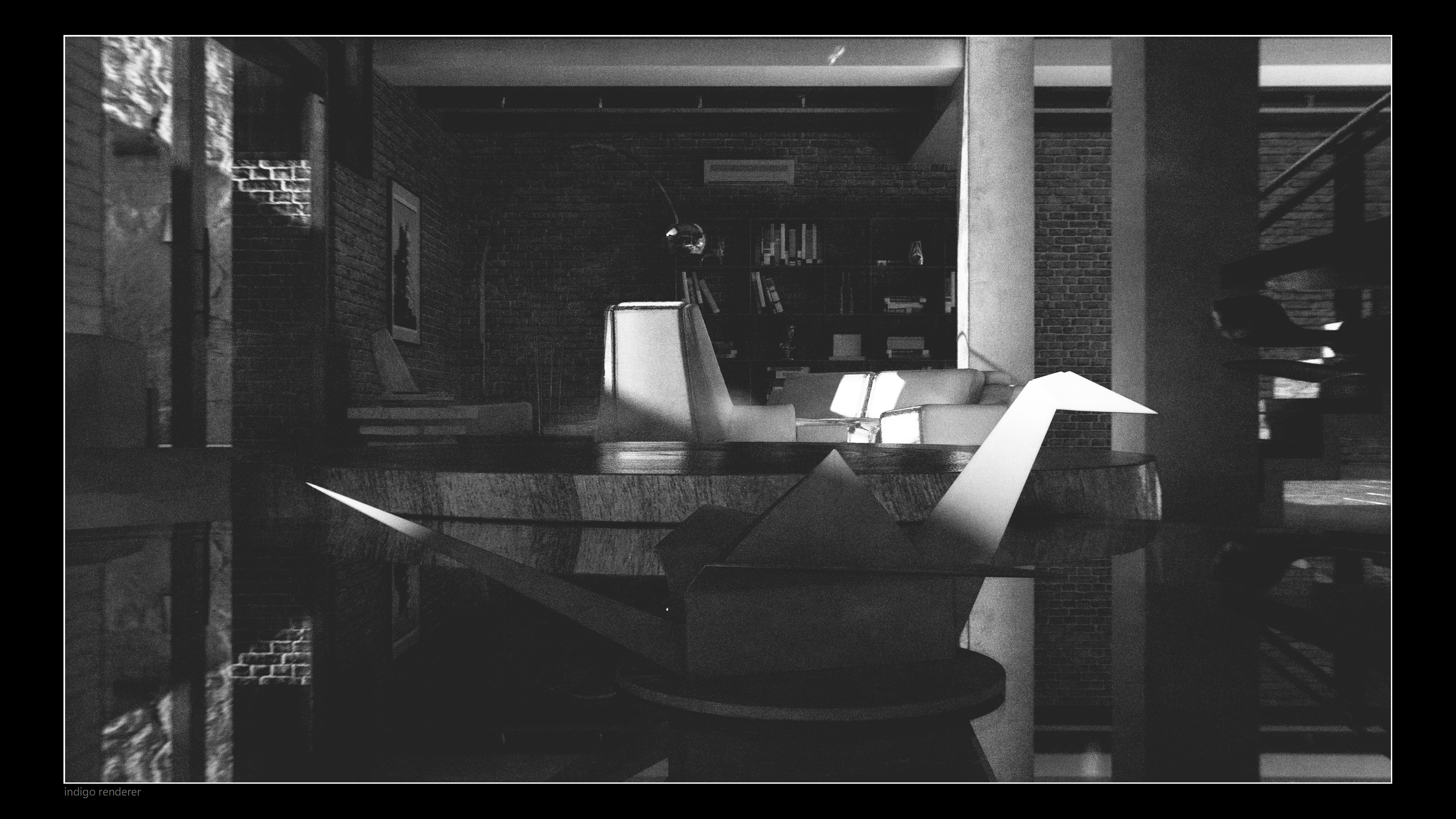

Post by yonosoy » Sat Jul 09, 2022 10:05 am
11h 23min. A masterpiece of light. Only possible with indigo. Not finished indeed, better. Some space to imagine. With problems with model and smoothing... the same, a masterpiece of digital artesany. If you love indigo for a reason, this is one of this...
canon_24mm_50.rar
(10.66 MiB) Downloaded 706 times

Post by pixie » Sat Jul 09, 2022 9:46 pm
amazing mood, ethereal even!

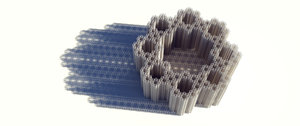

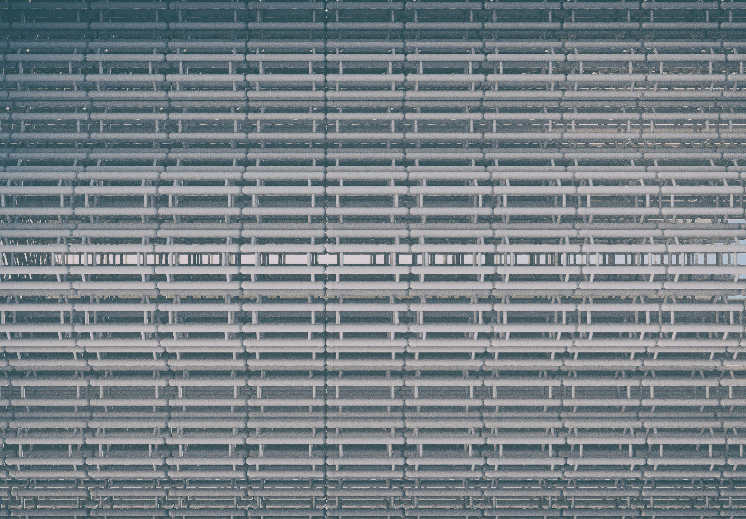

Post by yonosoy » Tue Aug 02, 2022 5:59 am
Hello Alamy, thank you.
About the questions of the other thread, I will try to manage new planetary scenes and is planned to share the workflow. It is very simple and too complex at the same time. Stay there...
The other question is simple, enclose your scene within a box (a bit bigger) and give to it a specular material with an IOR of 1, no absorption and a subttle SSS (try some values), try the uniform spectrum for the mediums and give to it a precedence of 2 (don´t forget to rise other material precedences if required).
8∇_(S966). Or simply "matter".
80 hours of render, +63K samples per pixel ... perfect spheres are in this way ... The concept is essential and exact. Try to poligonize the spheres and you got a perfect image in 20 hours (but not this apperture diffraction). The HDR manipulation is needed to see all the light process but dirt a lot the solution. There is to see what must be seen (erotic). Perfect spheres don´t work in indigo 4.6, try 4.4 sereies or the first 4 series for physical apperture. :)
matter.rar
(146.24 KiB) Downloaded 688 times
8∇_(S966).pigs
(4.55 KiB) Downloaded 649 times

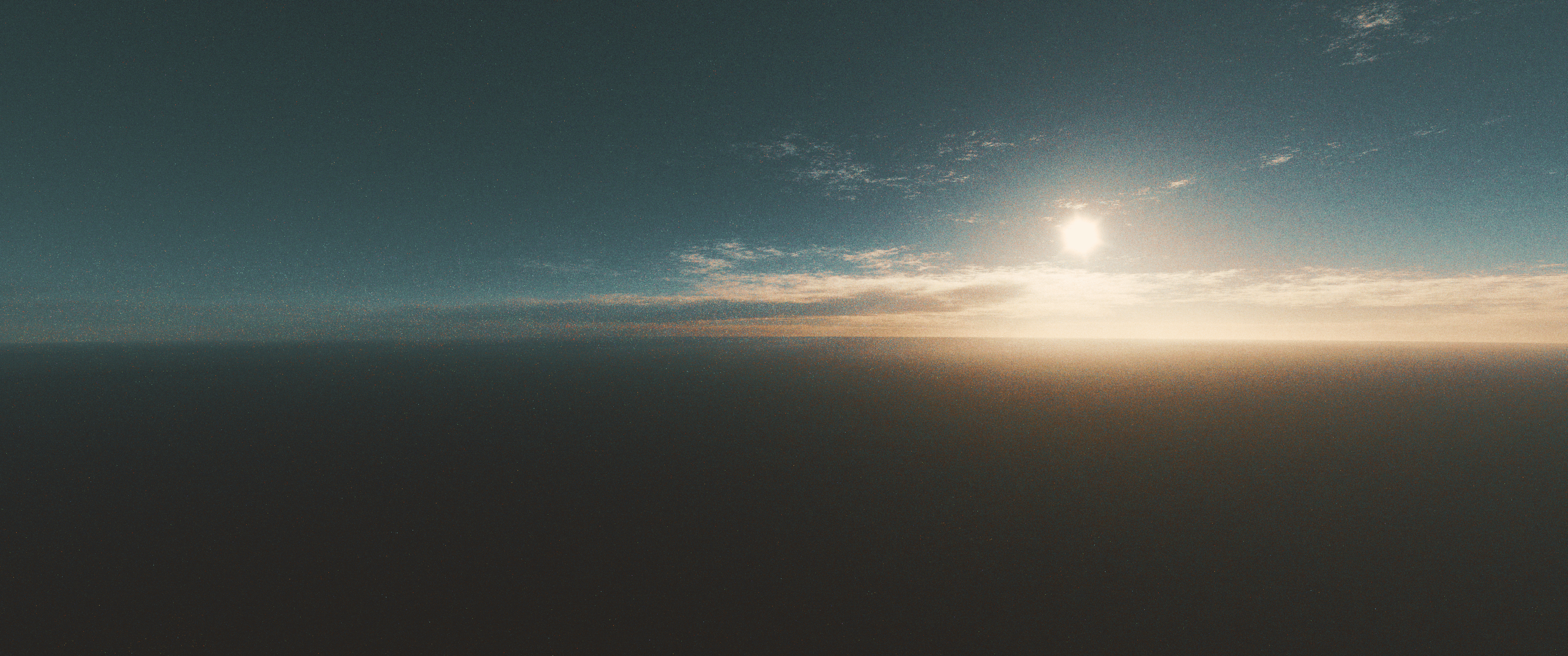

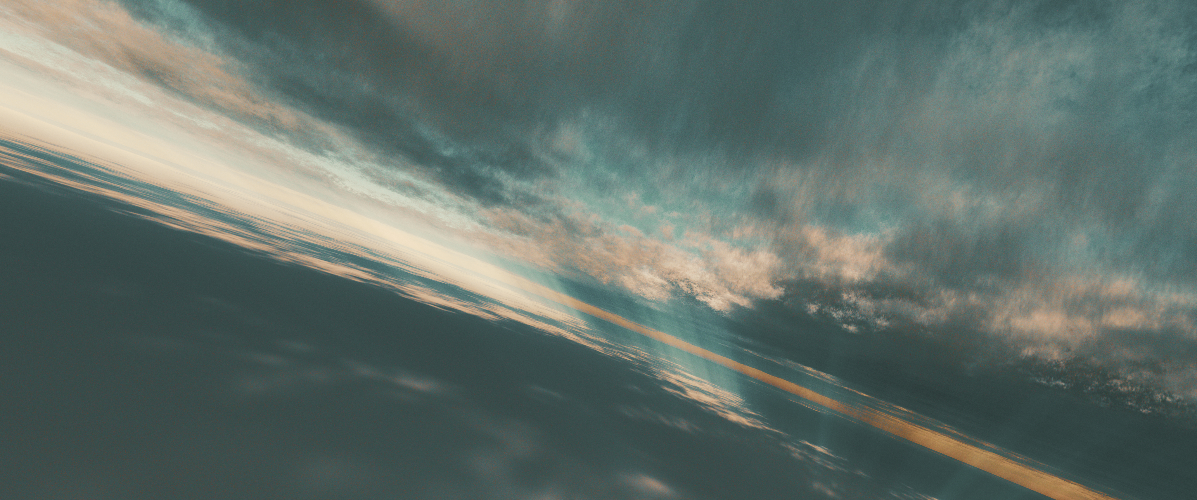

Post by yonosoy » Wed Aug 03, 2022 12:16 pm
9h pure 4K.
40h pure 4K.
0:30 h pure 4K.
Bronzes, the origin.pigs
(35.03 KiB) Downloaded 700 times
If you obtain a cool picture from whatever scene I was posted, please hang it here and we talk about :)
This three are renderer with the 4.4.16 release...

18 min. Metropolis bidirectional. Pure 4K.
yonosoy
Posts: 3439
Re: h
Post by yonosoy » Wed Aug 03, 2022 2:57 pm
42 min., metro bidir, pure 4K.
Que se note que es un renderizado porque se distinguen unos pixeles de otros es bello. Esto es difícil de vender a un cliente, pero no tengo...
57 min. When I discover why the eliptical diafragm lets a bright spot I will share the cam again. Near to be perfect...

Your work and renders are just incredible, can you tell me where I can find the mie_cumulus phase function, I want to make some tests.

I want to achieve the same effect that comes from the sun rays with the trees, Is this done by the box & Fog way?

Post by yonosoy » Sat Aug 13, 2022 7:38 am
You must change the tag "uniform" for mie_cumulus with a text editor, is not inplemented:
</scattering_coefficient>
<phase_function>
<mie_cumulus>
</mie_cumulus>
</phase_function>
Render settings, render mode, metropolis bidirectional. Test it. Seems that you are a "GPU animal" :) (is normal, I understand).
The top of the box is deformed with a meaning of the landscape (very few polygons, less octaves, same code. Do it in houdini is simple. If I have time I give examples of that. The fog is mie cumulus.
