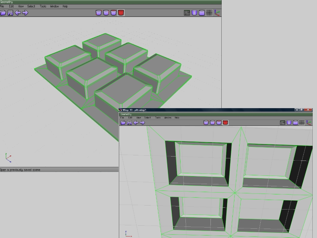

Post by neo0. » Sat Aug 02, 2008 7:12 am
Nice. One quick question though, how did you make the opening of the bubbles the same shape as the bubble itself? Whenever I do it, the opening is a different shape. The bubble looks like how it should, kind of a smoothed rectangular shpae but the bottom is always circular. :?
How does your mesh look prior to smoothing?
Mesh before smoothing
wingss huh.jpg (234.29 KiB) Viewed 3581 times
Post by StompinTom » Sat Aug 02, 2008 8:46 am
cuz you have to bevel the opening edges too, otherwise it will neatly subdivide to an oval.
